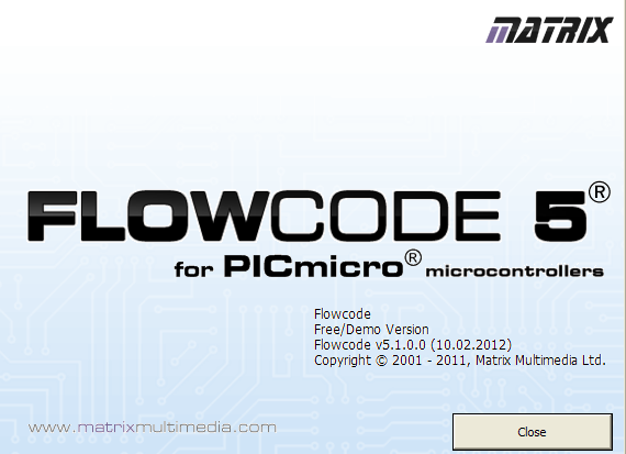

It really seems strange, I have the 5.1 demo version and I want to ask you if I use a delay of 1 s for a stopwatch or clock, will it delay 1 s? That's what I'd like to know to calculate a delay for a clock or a kitchen timer for example.
- fc v5.1.png (65.62 KiB) Viewed 18262 times
