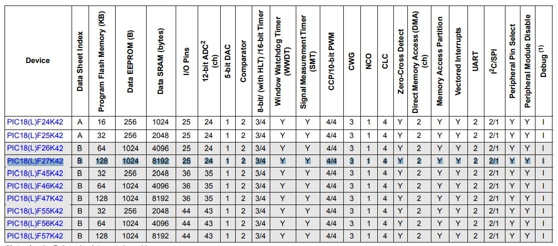

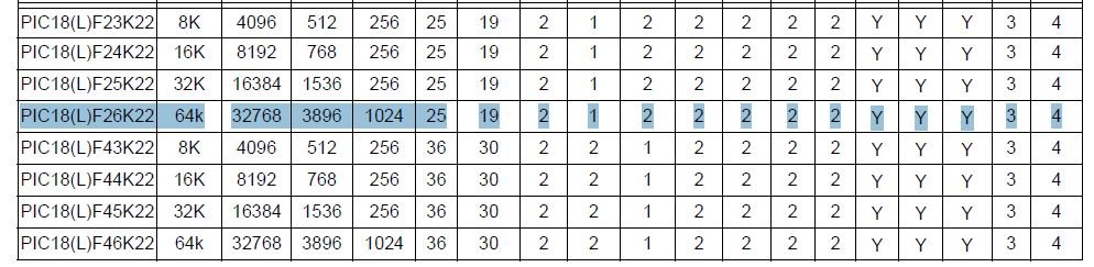

Re: I2C Problem on Pic18f27k42 (*UN SUPPORTED and buggy do not use this chip)
Hello! Chad
good morning
Kindly excuse if my information is not relevant or helpful.
For last few months I am using 18F26K22 for some application, no doubt the memory is less as compared to 18F27K42 but I thought to share this information only because I used the I2C (hardware) in 18F26K22 for OLED display and it works fine, I don't know if this information is helpful for your for your application.
Thank you.
Abhi
good morning
Thank you.
Abhi
- PIC18F27K42.JPG (140.7 KiB) Viewed 33056 times
- PIC18F26K22.JPG (76.63 KiB) Viewed 33056 times
