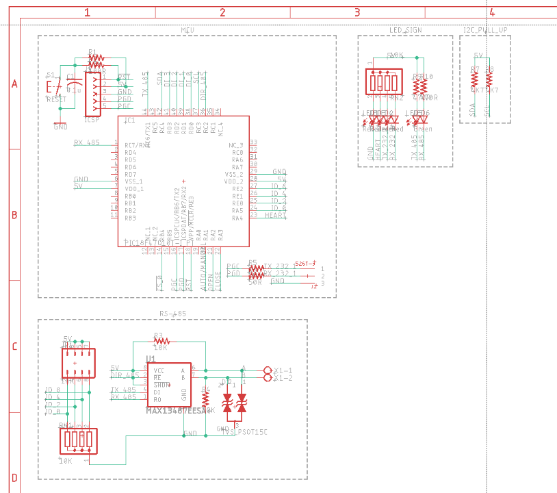

Re: PIC24fj256GA406 RS-485 Based Modbus RTU
Thanks for letting us know regarding the Q10 device missing it's channel 2 interrupts, these have now been added for you.
Let us know if you spot anything further using RS485, can you share your hardware setup with a simple schematic just to make sure everything here is ok?
In your schematic you are using a max13487 transceiver.
This chip has a build in state machine for auto direction control.
You do not need to use the DIR pin from your microcontroller.
Just connect the the RE and SHDN pins according to max13487 datasheet and use RS232 ttl method instead RS485 in your flowchart.
George
George
