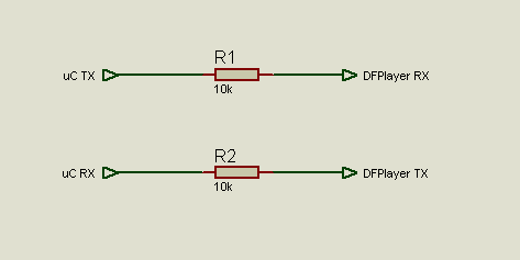

Sorry, i've forgotten an important thing, what is helped for me:

Thanks to both, I'll try the 10k resistors.. the 1k in the tx doesn't make much difference.

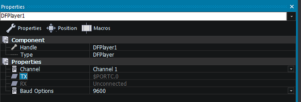

To get around that, the component is created with the target set to say 16F18877 or any of the 16F15xxx.
With mapping there is a bug to select pins.
To get around that I just select UART software then back to hardware.
Unable to test received commands due to mapping not exposed.
This is what happens:
Mapped pins not available..png (41.57 KiB) Viewed 17719 times
