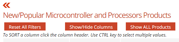

To choose a pic, there is an online tool. There you can select:
8Bit Pic and 3pcs i2c and you will not found even one. If you reduce to 2pcs i2C you will found a lot.
or if you select:
16Bit and 3pcs i2c, you will found a lot
There is a thing about the tool. It shows you just new/popular pic. If you like to see all (your favorit PIC16F1847) you have to click ShowALLProducts
or if you select:
