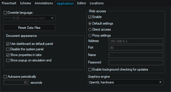

If I change graphics engine to software it's working again.

If I work with single monitor every thing is working fine. I can doc and undoc the 3d systempanel and 2D dashboard and put that anywhere on the screen.
When I use second Monitor and move 3d systempanel or 2D dashboard on the second monitor it's crash.
happens immediately or at the latest when starting the project new.
but in opengl software mode it's always working nice.
For me it's ok to work in software mode.

To work in softwaremode give some problem in the windows with component with a display like the wii nunchuck.
The good thing is, with the new Nvidia Driver update from today 2020.10.21. Flowcode is working nice again in hardwaremode and on a second screen.
