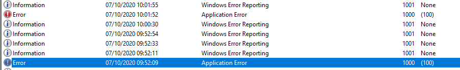

I have got entries in the Application log / Event viewer from fc8 crashing yesterday, here are two of them - most are just about the same.

Thanks for the info. Please send me the program you were simulating and I will try to replicate the error.

I have been able to confirm and replicate your crash, and I think I've found a workaround. If you set the 4 PWM objects' "Representation" properties to "Digital", the problem does not occur.
The problem is Flowcode is running out of memory during the execution of this particular program and seems to be linked to the calls to change the duty cycle. If you run the simulation you can see Flowcode's memory allocation increasing in Window's Task manager.
Some partial good news is that the problem does not seem to be present in the next version of Flowcode and both "Analogue" and "Digital" representations work ok.
