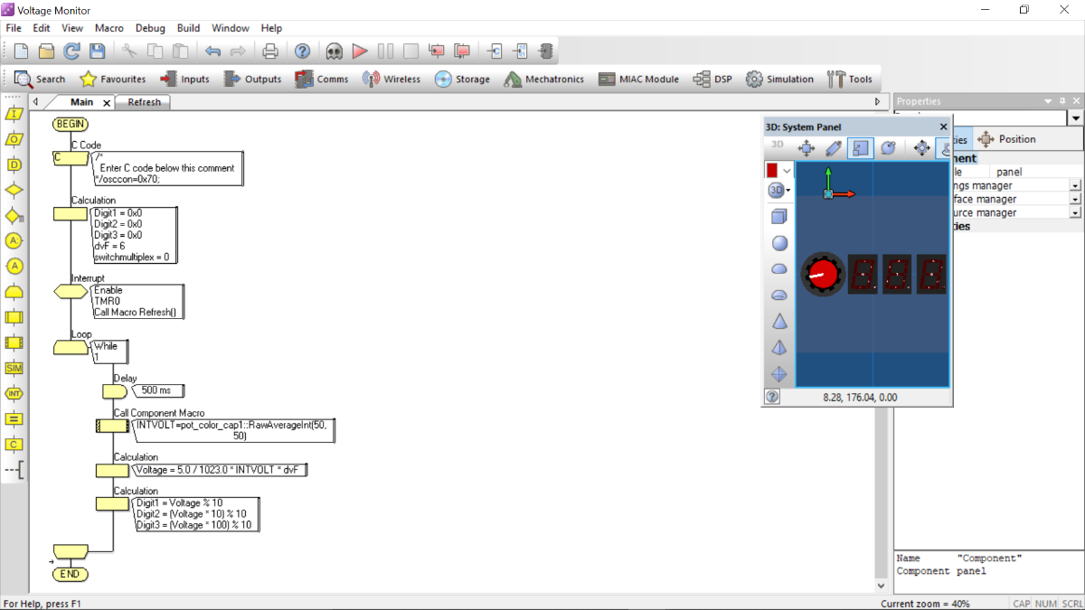

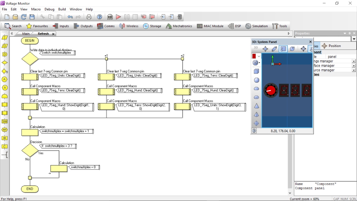

Re: PIC16F1503
Hi Martin.
As per our last correspondence, moving further I have added a potentiometer to read analogue values. MOD calculation used to display individual digits. But it seems I am still missing something to get it displayed. In the screen shot attached with his message In calculation icon when I write Digit1=1, Digit2=2 & Digit3=3 then its displaying correctly, but when I add MOD calculations for all three digits the display behaves abnormal by displaying unknown characters, blanks apart from know numbers and freezes. While simulation is working perfectly. Need your assistance to understand what could be this issue.
Regards.
Juzar.
Regards.
Juzar.

Re: PIC16F1503
Hi Juzar,
Glad you are getting further.
Thanks for letting us know.
It's not easy to follow screen shots to see what's going on.
Can you post your flowchart and I will take a look at it when I home from work,

Re: PIC16F1503
Hi Juzar,
Please bare in mind that Flowcode 6 was released in September 2013 is no longer supported.
Just had a look at your flowchart.
If you look at your calculations, you have got multiply instead of division:
It should be in this format.
You have three 7seg displays and the calculations for the displays will be based on hundreds tens and units.
So if the voltage result is 10.8, you will only see 10.
Another example if the voltage is less than 1 you will only see 0.
The solution will be to multiply the voltage result by 10 & use a decision branch to make sure the decimal point shows in the correct place.
What I would also recommend you do is test with a fixed Voltage calculation.
E.g Voltage = 123 & try Voltage = 12.3
That will make sure your 7seg displays are configured correctly.
If you are still getting 0 for the voltage value, then you could have an an issue with ADC assignment.
Have you assigned flowchart ADC to corrisponding ADC on hardware?
Digit2 = (Voltage * 10) % 10
Digit3 = (Voltage * 100) % 10
