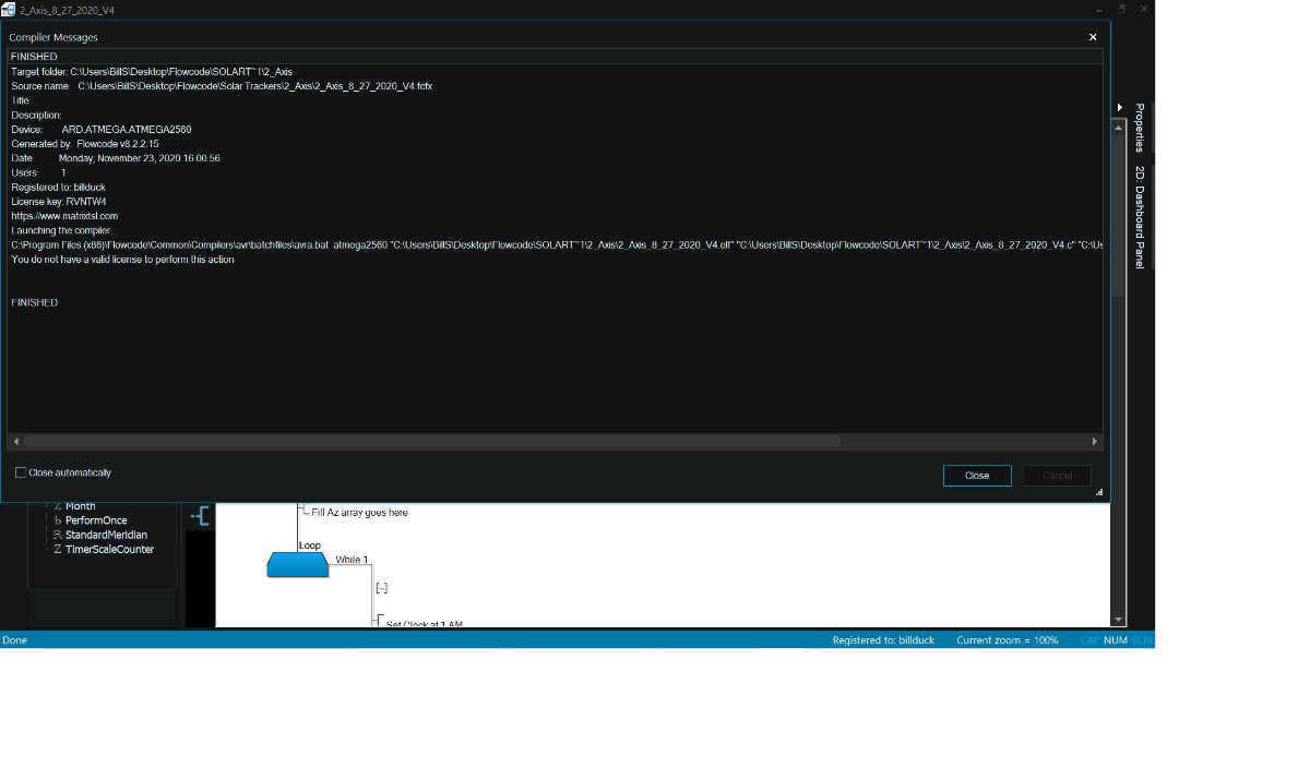

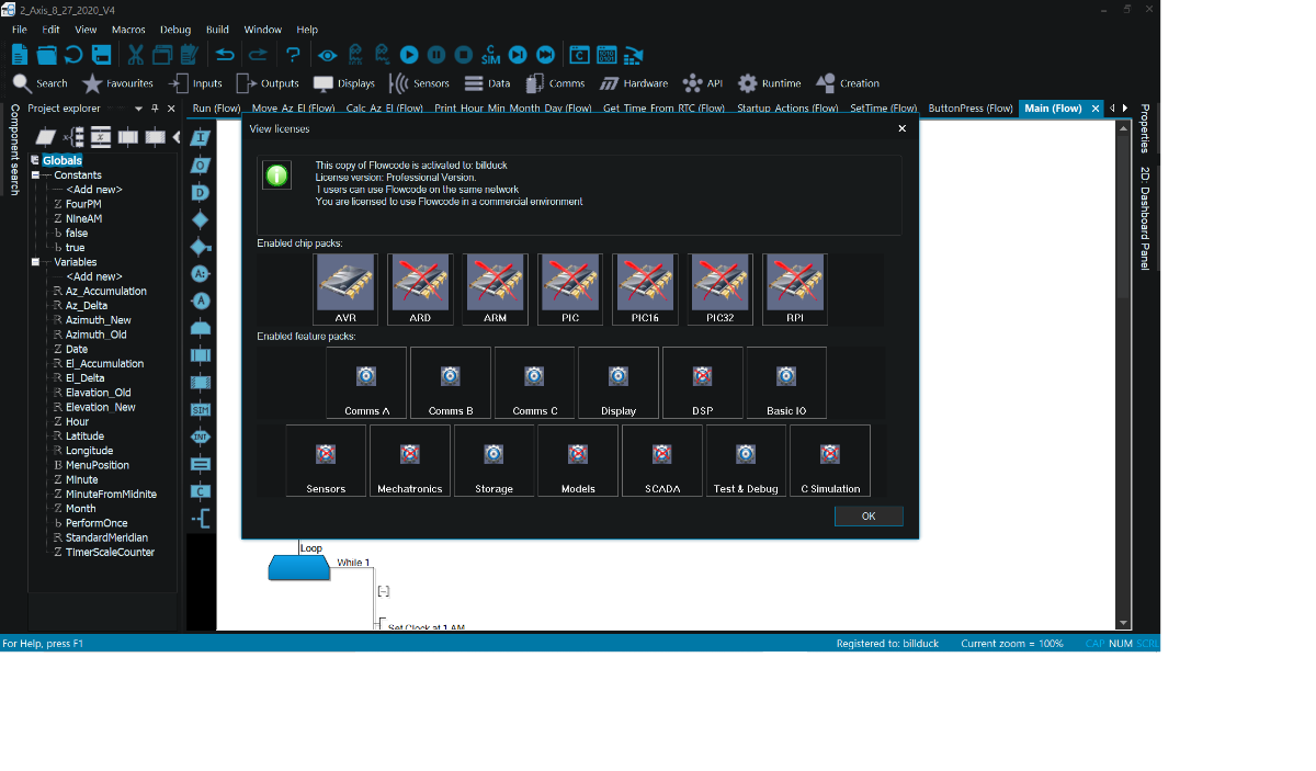

I am having to use a MEGA instead of the UNO because the HEX file size is too large.
The 2 picture files, attached, are the permissions dialog and the error text, cited below.
The error message is "You do not have a valid license to perform this action."
The permissions dialog indicates I have the AVR but not the ARD (assume this means the Arduino). But I routinely program the UNO.
Can I get help to rectify the situation?

- You do not have a valid license to perform this action..png (103.1 KiB) Viewed 4116 times
- Flowcode Permissions.png (209.15 KiB) Viewed 4116 times

Re: Programming to Mega 2560 - No Permissions
I might add, what is the URL to purchase additional permissions?
Hi Bill,
The Uno is one of the free targets - so yes, you'd need to buy the Arduino pack to use the Mega...
First, though, is it possible to 'trim' your code to fit. (I once went to a lecture where it was asserted that all programs can be optimised by (at least) one instruction - this of course leads to all programs being pretty (ok very) short...
I'd hesitate (slightly) to buy at the moment - if you are thinking of purchasing v9 which is due imminently (unless Matrix give you a very good upgrade offer?) - some of the new targets (ESP8266 for example) might be a better fit (bigger & faster (and possibly cheaper)). Might also be worth looking at some of the alternatives in the AVR pack and using them - it might be possible to use the Mega2560 chip and program the Arduino Mega using either a usb-tiny type programmer (or a second Arduino) - or just some command line code with avr-dude.
Or maybe step-up to the Raspberry-Pi??
If all else fails head to https://www.flowcode.co.uk/flowcode/buy/
