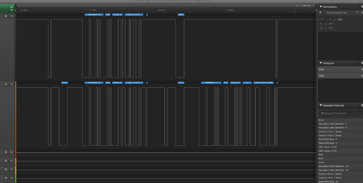

My English is not good.I am a user of flowcode v7.I built a 10-node internal canbus communication network with pic18f25k80.
I can read buffer0 bytes coming from the first 3 nodes with modbus.but I cannot read signals from 4th and other nodes even though I see them on the digital analyzer.I cannot read point 4 even though it has the same waveform as other running nodes.
I will be glad if you help me.
