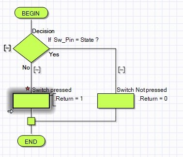

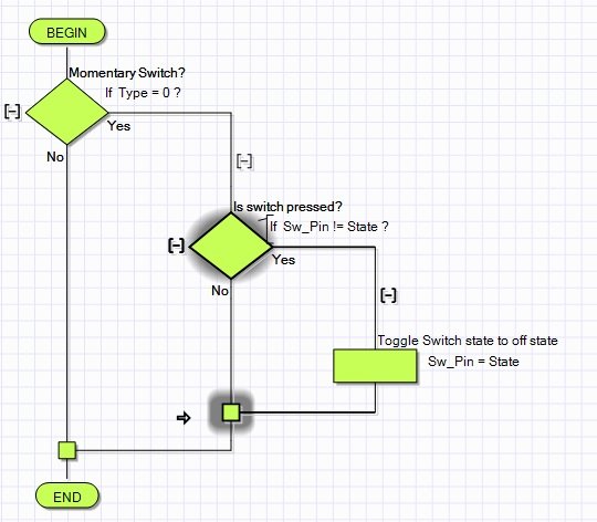

Sorry spotted a bug in the Ev_Release macro.
Should be this.
Also another in GetSwitchState macro.
Should be this.

Re: Simple switch edit
If you wish to reset the switch state then create an event macro for the Simulation start event using the Events tab of the project explorer.
Inside the macro use a calculation to set the following code and that should reset the state on run.
Sw_Pin = State
Sw_Pin = State
