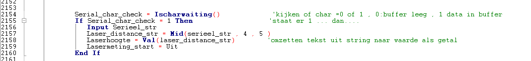

I'm struggling for a long time to receive data from my serial laser unit which i use to measure distance.
I did a lot of programming in Bascom, and in Bascom it works perfect. i try to do the same in flowcode as i did in Bascom. but i don't get some values at all, and sometimes one or two bytes. But never more!
I sent an attachment which i use in Bascom where it works perfectly, and i sen my flowcode which doesn't work at all...
hopefully someone could help me...
Friendly regards
Ronny

Hi Ronny,
The isCharWaiting function doesn't really have an equivalent in FC - what to do is to have an Rx interrupt that puts received characters into a circular buffer (either the FC component or a simple array and counter)

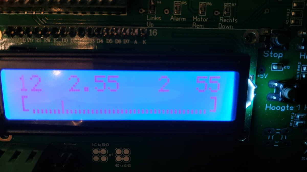

But maybe something you like, and i want to share it with others...
i made a bar graph display to be used with a value within value limits...
for example a value has a lower limit of 10 en an upper limit of 30, so the value can be in between these limits.
The Bar-graph shows graphicly "where " the value is. you can realy see if it is almost to the upper, lower or maybe in the middle of its range.
it calculates the usable bar graph positions of
example:
this is how it looks right now...
lower limit is 8, upper is 30...
upper line left is the real value
2.55 (string rounding 2 decimals), is 2.55/14 (14 usable digits) 2 markers at the side makes 16.
2 gives the number of the string
55 gives the decimals of the string as number.
I'm working on a project which also requires a menu, and i want to use it to see what the values are according to its limits...
of course the limits and parameters will be placed in the eeprom and can be modified from the menu.
I was searching for a site on matrix or flowcode where people can upload completed projects to share.
is there such a site , because i can't find it anywhere?
If you appreciate it i could also upload the files....
Friendly regards,
Ronny

Glad to hear you got it working. That bar graph - graduated display looks great!
