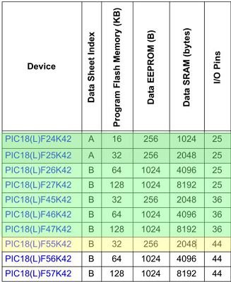

Would it be possible to get support for PIC18F55K42?
Flowcode already supports PIC16F45K42, which is exactly the same chip family, only with fewer pins.
The ones in green are already supported by Flowcode, we just need support for the one in yellow...
Many thanks in advance!
R
