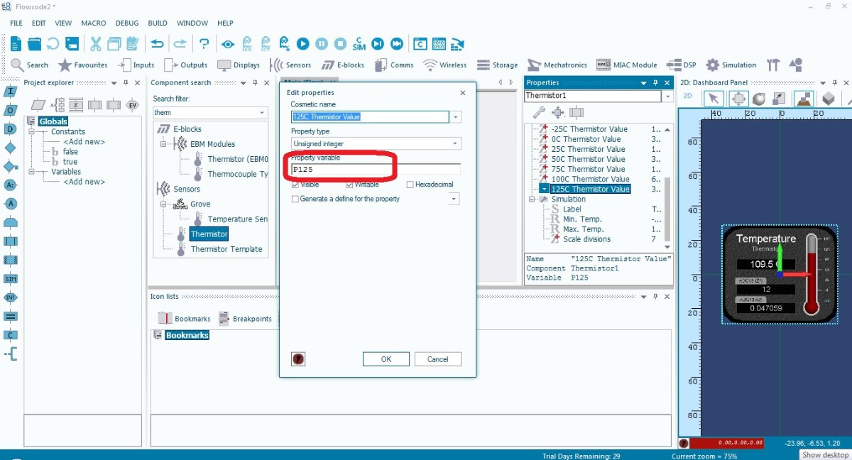

Is there any way to edit thermistor reading to more than 125c?
I need to measure up to 150c, but cant change "property variable" from p125 to p150.
Can't edit max thermistor temperature

Hi, John.
Welcome to the forums.
125C is the maximum calibrated value you can use.
I believe it's not designed for higher temperatures as the temperature is calculated by linear interpolation, so it will start to become widely out of tolerance.
An alternative is to use a formula for temperature calculations based on the thermistor resistance value.
One such example can be found here.
I have found the method used within the flowchart to be surprisingly accurate.
