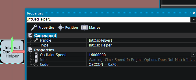

There is a component within Flowcode called Internal Oscillator Helper You can find that within Runtime, or you can use component search and enter intos
Select 16MHz.
That will give you the value of
OSCCON=0x70;
Internal osc1.png (21.83 KiB) Viewed 32611 times
Select it all and right-click copy.

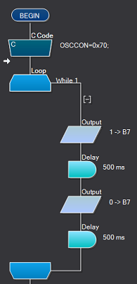

Add a C code clock at the top of main and paste
OSCCON=0x70;
OSCCON Setting 16MHz.png (27.25 KiB) Viewed 32594 times

I have noticed you did that with 500ms delays.
Can you time the flashing LED and let me know how long each flash is?

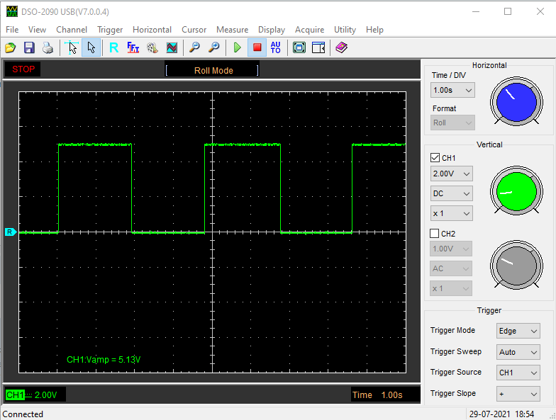

I set the scope to 1 second per division and it give me just under 2s, but what I can understand is that the display on the board is displaying correct.

If you are using a 500ms delay then the 2 seconds states that the PLL is not being enabled.
Displays are forgiving with osc speed, UART is not.
