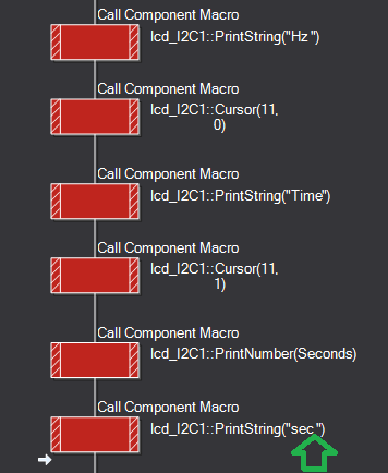

hi all
ive attached a very small part of a project im working on and im pleased with the results BUT ... when this particular part is run i cannot remove the last letter from the bottom of the display when used again ie the part that says "sec" moves to the right 1 digit when the count goes over 9 secs but if you start it again i now have "secc" on the end of row 2 instead of "sec", ive tried adding printstring " " etc but cant figure out how to remove this when the operation starts again :oops: :oops: :oops: thanks in advance

Hi Bob.
Just add a single space here:
Add a Space.png (22.51 KiB) Viewed 11155 times

hi martin
as always thanks for the reply, i had previously tried what you suggested but this didnt work and after much head scratching i realised the problem, the flowchart ive added is just a snippet of the whole design, im actually using 3 branches on the switch icon and each branch has the same parts you have highlighted in the reply, it seems the problem was that each branch needed on the printstring icon to be "sec " where as the particular branch i showed was the only one i tried with "sec " the other 2 branches were "sec" when i changed these 2 to "sec " it worked correctly, hope ive explained that well enough lol its now doing what i wanted but i appreciate your input many thanks
