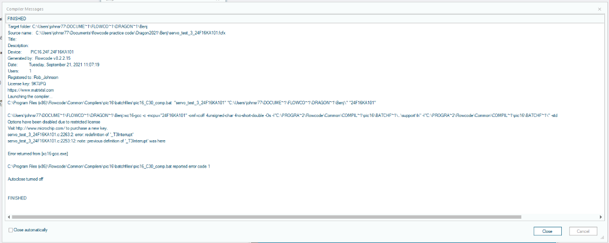

Thank you for the quick reply, I tried to compile the program, I didn't change in any way and it returned errors
I have attached a screen grab.

Had a look and realised the Interupt used tm3 as well as the servo component, so I changed it to use tm1 and the code compliled and ran, however I still had the problem of incorrect timing of the servo pwm signal
