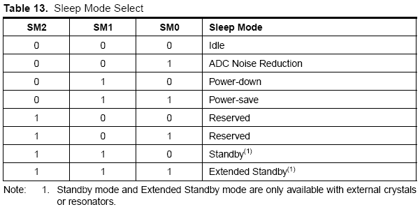

Re: ADC NOISE REDUCTION in AVR
According to the MCUCR register tables:
I want SM0 = 1, SM1 = 0, SM2 = 0 to be in the MCUCR register Until Sleep Mode changes to ADC Noise Reduction mode.
You can set bits in the registers using a C block
to set use | (or) and to clear use & (and)
in this case to set SM2 to SMO to 0b001 (binary)
MCUCR = MCUCR & 0b10001111; // Clear SM2 to SM0
MCUCR = MCUCR | 0b10000; // Set SM0 to 1
In the real world these would probably be combined into one line:
MCUCR = (MCUCR & 0b10001111) | 0b10000;
I used this code in C block but there was no change in the ADC reading.
The value read from the ADC fluctuates continuously, albeit slightly.
I have complied with all of the above regarding ADC circuit power supply.
