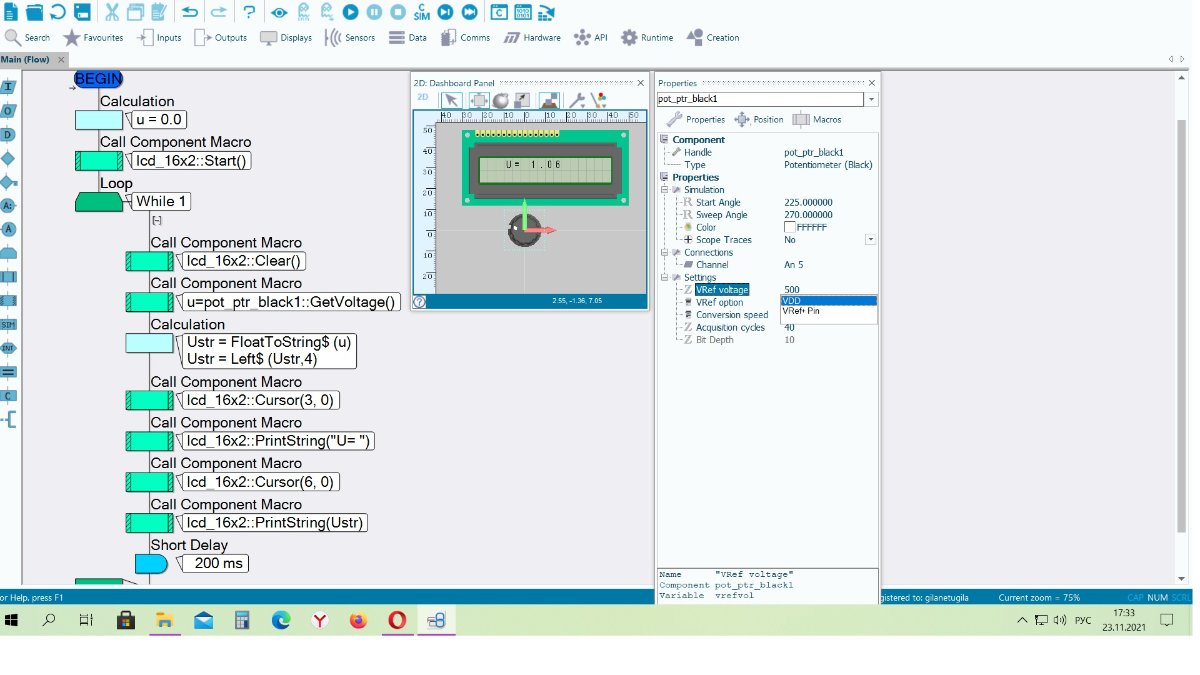

Excuse me! I didn't know how to send a message. I can just reply to your letter. Or you need to enter another topic or section. You wrote that it is necessary to change the Vref parameter from AREF to AVCC in the properties of the potentiometer.But I have (in flowcode 8) only the VDD option on Vref+pin ? Or am I looking for that there? See in the attached file.
parametr Vref.jpg (110.33 KiB) Viewed 20926 times

Yes, sorry I was thinking of a different target device, VDD requires selecting.

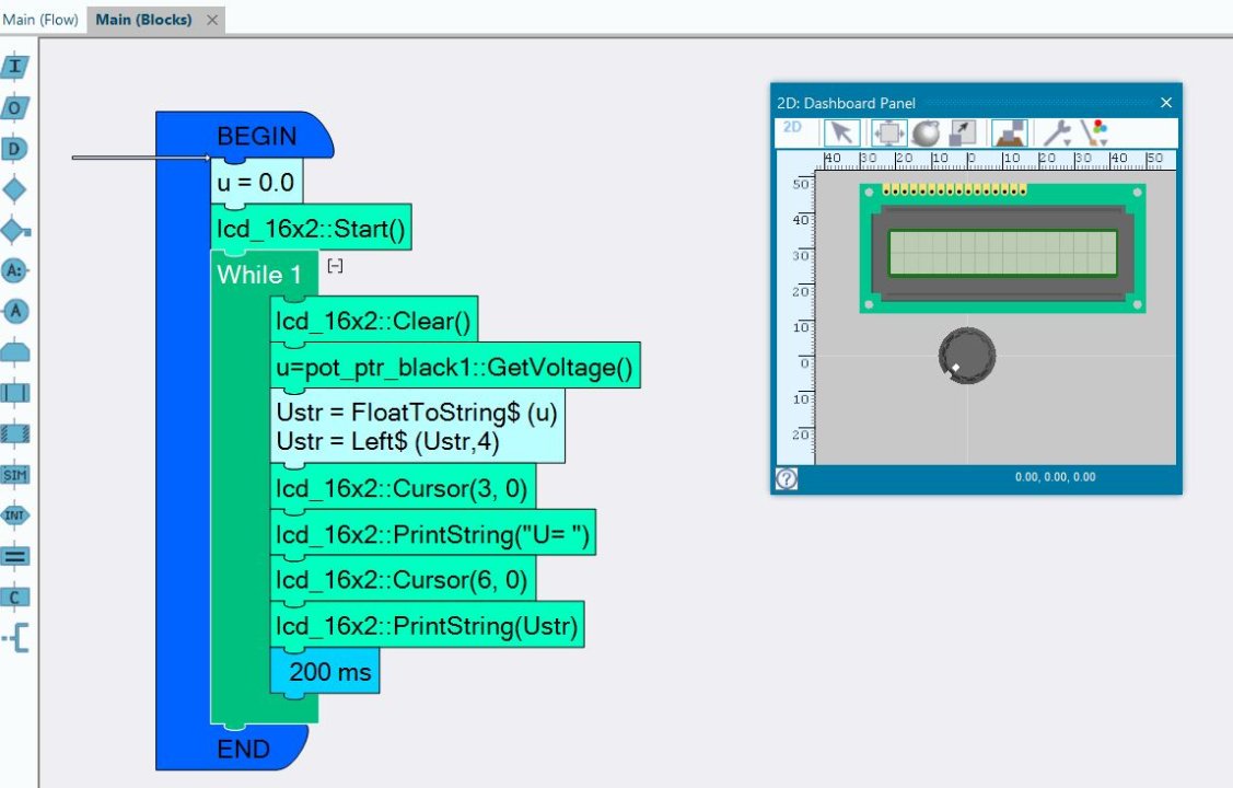

On the attached file there is a screenshot from the screen with the program properties

Can you post your flowchart please, as the generated code looks OK

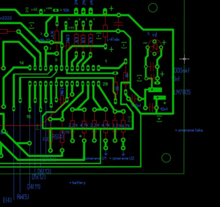

I have a diagram drawn in the sprint layout program (drawing of an electronic board) and a drawing from the site where I connected the elements to atmega8. See in the attached file.
theoretical scheme.JPG (80.68 KiB) Viewed 20892 times
real scheme.JPG (87.9 KiB) Viewed 20892 times

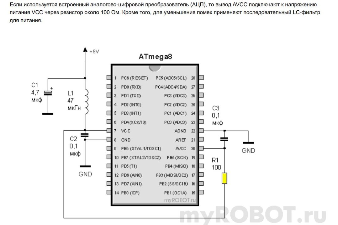

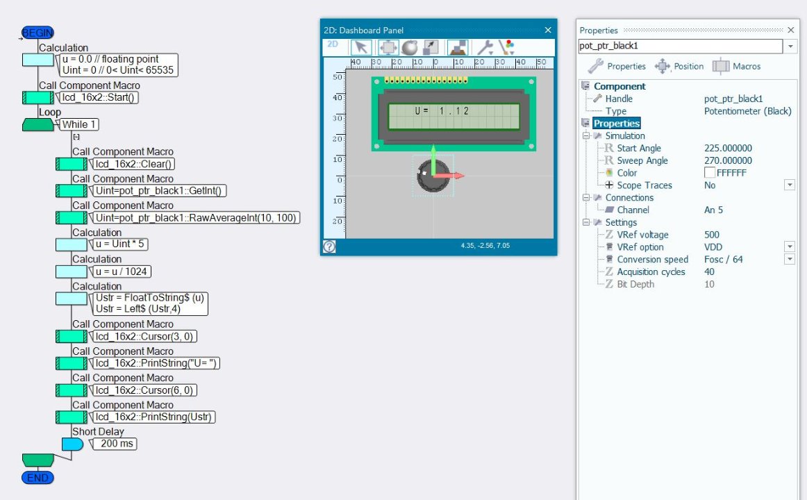

Good evening ! I went through various sources and found out that: using the program that I made is difficult, because it is impossible to average the voltage values and there is no way to take into account the value of the reference voltage, in addition, I found out that using the reference voltage from the power supply on the LM7805 is more preferable than using the internal reference voltage. I also found out that in order for the VDD mode to work as a reference, you can connect the pin Aref through a 10 nf capacitor to the ground (or you can not connect it) and leave Vref option=VDD in the potentiometer settings. Despite all the manipulations done on a real device, 4.99 is still hanging on the An5 output under test. In this connection, the question arises to the specialists-where did I make a mistake?

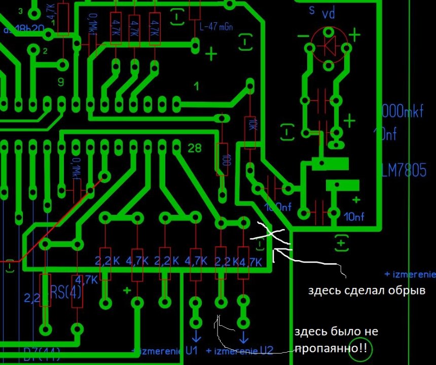

Good afternoon! I found a malfunction in the real circuit tonight-the voltage divider resistor connected to the ground was not soldered. This was discovered by chance, when measuring the voltage on the divider using another voltmeter.(tester).
где был не пропой.JPG (120.16 KiB) Viewed 20520 times
