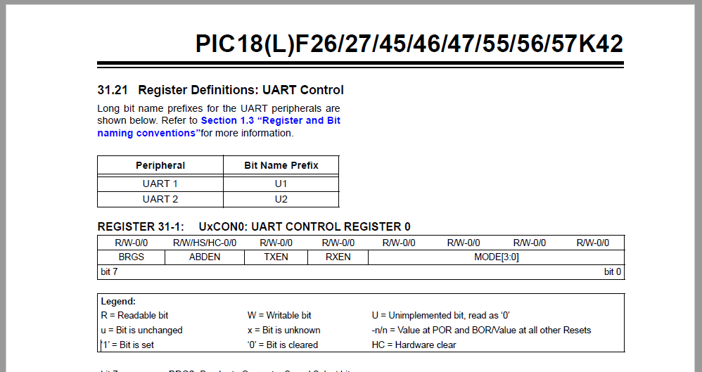

After reading the datasheet of the same chip (page 499 to 501, datasheet not able to attach due to size), i found few settings for UART Control Registers, in these settings i noticed it was possible to set the Parity as well the Stop bit for the UART (if i am not wrong the Modbus slave is working on RS232 bus), may i know if it is possible to change the settings of this registers accordingly after Initializing the Modbus Slave and before the beginning of the Loop in the Main, is the change valid and acceptable if written in C block, if yes may i request someone to help me how it is done.

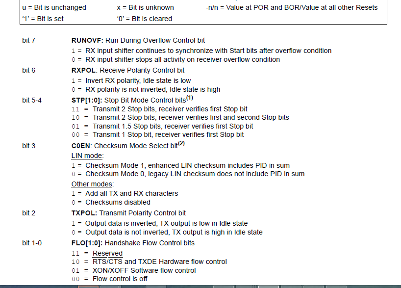

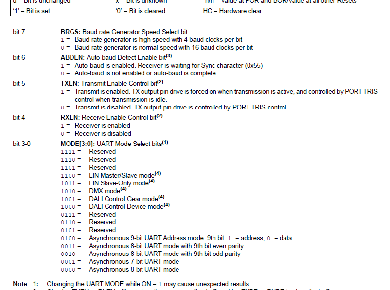

If you want to do the fix using C code then you can add this line to a C-icon after initialising the Modbus component.
Odd parity on UART channel 1
U1CON0 = U1CON0 | 0x02;
Even parity on UART channel 1
U1CON0 = U1CON0 | 0x03;
Two Stop bits on UART channel 1
U1CON2 = U1CON2 | 0x30;
For other channels replace U1 with U2 etc.

Finally, the Modbus is working now, the change in the UART properties, i.e., Parity and Stop Bit, is achieved, as per what Ben mentioned in his previous post about using the C blocks to change the functions.
One will need to read the datasheet of their respective chip, it is clearly mentioned in the same about how to configure the UART properties, unfortunately I missed the same.
One of my forum friends (Peter) helped me to solve the problem, it is as below,
To stop the UART
U1CON1bits.ON = 0;
Make the necessary changes in the properties
And again, start the UART
U1CON1bits.ON = 1;
