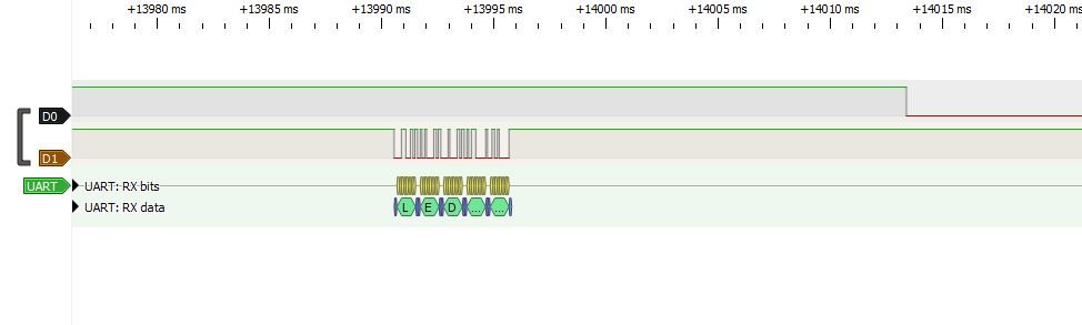

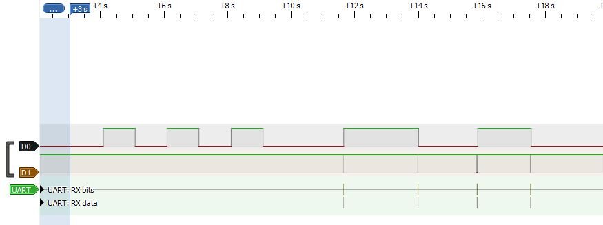

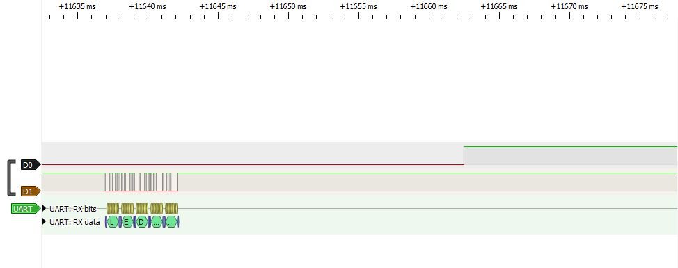

With reference to the attached I've quickly knocked this up to toggle an LED via UART.
It isn't complicated and there are countless ways to achieve, so just consider it as a way you could do it (and probably more elegantly too <s>)
Three components and the WiKi will give further explanation and examples of each if needed:-
LED
UART(RS232)
Circular Buffer
After initialisation we enable an interrupt on RXINT0. This interrupt causes the program to automatically jump to an Interrupt Service Routine whenever we receive incoming data on the UART. In this routine we simply collect the incoming byte and store it in the Circular Buffer.
We then enter an endless loop. In this loop we check to see if the Circular Buffer, populated by incoming data received via the UART, contains our "trigger". If the "trigger" is present we then toggle the LED On/Off.
The "trigger" phrase in the example is LED but could be anything you wish within reason.
If you set one of the HC-05's to be a slave using your PC as per a previous post, and connect to your PIC (I've used a 16F1939) via level-shifters if required, and then connect with your phone running a terminal program, whenever you send LED from the phone the LED will toggle On/Off.
In my FC7 chart the Circular Buffer component appears to be invisible but it is in the chart underneath the LED somewhere. I probably did something stupid with it.
I haven't used FC7 in a while and I don't have any hardware available to test with so........Hopefully it should work
LED
UART(RS232)
Circular Buffer

Initially some issues but that seemed to be because I still had the chip plugged into my Dev-Board. Once on a bit of breadboard all worked to plan.
Connections as you would imagine.
I had a cheapo logic analyser connected to the chip A0 (LED Output) and also the Rx pin. Traces D0 / D1 respectively below.
I altered the chart to run on Int Osc @8Mhz and included a flash test to verify before enabling the interrupt etc.
You can see from the traces that the chip flashed three times as planned, then when the trigger (LED) arrives on the Rx it toggles the output a few mS later
Traces
Output changing state to On
Output reverting to Off
I've attached the chart for the 1825 that works for me. Hope it helps.
