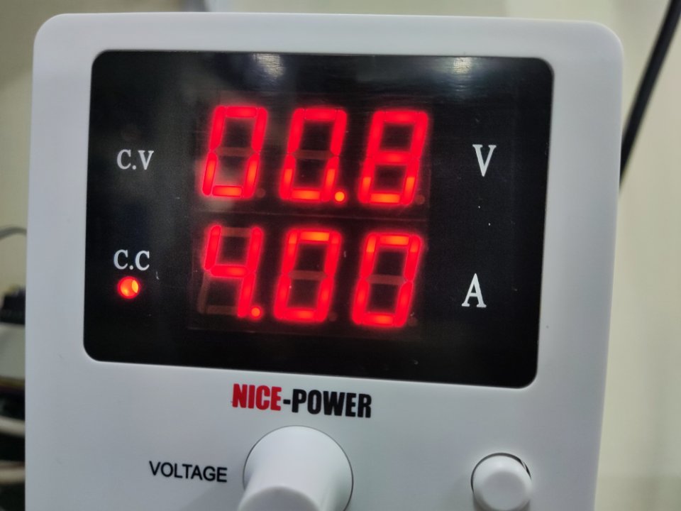

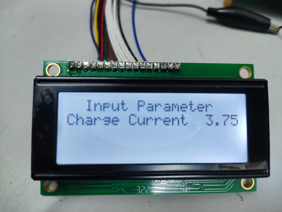

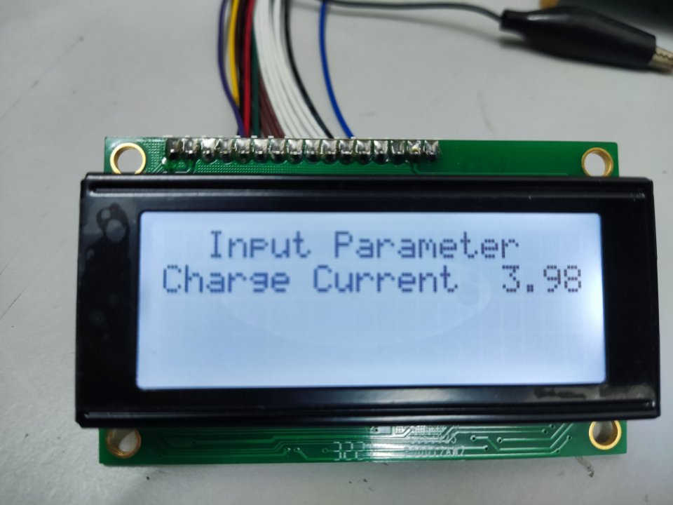

I was recently writing some code to read the current value in the LCD Display but unfortunately, I was getting a high fluctuation value in the display after I upload the hex file to my hardware. When I was doing Flowcode 9 simulation the reading was perfect in the software tool simulation.
My digital PSU shows perfect current value 4.0Amps,after I load the hex file into my hardware there a high fluctuation happens.
I have attached the fluctuation pictures in my LCD display and my digital power supply current reading.
I need someone's help.
thank you
thank you
the value was jump from 3.75A TO 5.39A this always happens , i also have set the delay from 1sec to 3sec is same and i have chage the oscillation speed from 4.0Mhz to 20Mhz is also same thing was happnes.
(THIS WAS MY SECOND POST)
thank you

Re: Current LCD 4X20 fluctuation
What is your input voltage and what is the value of your load resistor that I assume connects across J24?
INPUT VOLTAGE: 0 ~ 12VDC FROM ADJUSTABLE DIGITAL POWER SUPPLY.
J24 : I CONNECT 1R/50W POWER RESISTOR
I have connected with battery 12v and test, the fluctuation is the same
I reduce the resistor value to 20R/10W on the J3 load side.
another method I inject voltage 1.2vdc directly to MCU RA0/AN0 and test for 5 minutes is show fluctuation, to ensure my hardware is ok.
I really do know how to solve this kind of problem
Thank You
Thank You
What voltage does your MCU operate at? I assume 5v but is it derived from the same PSU as powering the rest of your circuit?
Not the same PSU to MCU, I was using separate a battery input voltage 12vdc and have regulator ic 5V output and connected to MCU VCC/VDD PIN.
when I measure GND to VDD MCU POWER PIN, I GET VOLTAGE 4.98vdc which is the correct voltage point, and I also do some data logging with my BK Bench multimeter in the GND/VDD pin there is no voltage drop or fluctuation.
What values do you get when only powering the circuit shown? (when I was injecting with direct voltage to RA0/AN0 1.02V I GET READING IN THE DISPLAY ) the measuring current delay timer I set to 1sec and clear display.
FIRST VALUE: 2.75A
SECOND VALUE: 5.50A
THIRD VALUE: 5.27A
FOURTH VALUE: 5.73A
This value I was getting fluctuation some time can jump to 6.01A
Your PSU picture shows 4A but only 0.8v which suggests a resistance of 0.8/4 = 0.2 Ohms (YES CORRECT)
Have you checked your circuit for shorts/damaged components? ( I was total check my development Board there is no component damage or open circuits/short circuits in the board)
I also replace PIC16F877A and test, it shows the same results fluctuation.
Best Regards
FIRST VALUE: 2.75A
SECOND VALUE: 5.50A
THIRD VALUE: 5.27A
FOURTH VALUE: 5.73A

I have made you very clear since my first post in this forum.
YOUR QUESTIONS: Are you saying that your display is showing fluctuating values between 5.27 and 5.73 or is that what is happening on your PSU?
MY FRIEND IS NOT MY PSU FLUCTUATION, THE LCD DISPLAY FLUCTUATION BELOW THE VALUE
FIRST VALUE: 2.75A
SECOND VALUE: 5.50A
THIRD VALUE: 5.27A
FOURTH VALUE: 5.73A
PLEASE READ MY POST AGAIN
With your MCU disconnected, what voltage is your PSU set for and what does it show when connected to the schematic you posted earlier and what value is across J24? I TOLD YOU EARLIER THAT 12VDC TO THE J24.
With the settings you have, the resolution is 0.0048V but with your scaling that equates to 0.234. WHERE DO YOU GET 0.234? I HAVE NOT MENTIONED THESE NUMBERS IN THIS FORUM
I SAID I WAS INJECTING DIRECTLY TO MCU RA0/AN0 PIN 1.02VDC THIS VOLTAGE IS CONSTANT VOLTAGE FROM MY DIGITAL PSU IS NO FLUCTUATIONS.
EXAMPLE:
ADC Program Flowcode setting point
ADC0 /RA0/AN0
VRef voltage 500
Vref Option VDD
IF I NJECT DIRECTLY TO MCU PIN RA0/AN0
PSU Input Voltage LCD DISPLAY RESULTS
1V = 1AMPS
2V = 2AMPS
5V = 4.999 to 5.0A
this is the reading suppose I must get in my LCD, not more than this value suppose +/- Fluctuation 0.01 is acceptable.
But in my case more than a 50% difference I read on my LCD display, is unacceptable.
(Input Voltage 1.02V) (My display results)
FIRST VALUE: 2.75A 5.73A - 2.75A = 2.98A
SECOND VALUE: 5.50A 5.50A - 2.75 = 2.75A
THIRD VALUE: 5.27A 5.27A - 2.75A = 2.52A
FOURTH VALUE: 5.73A 5.73 A - 2.75A = 2.98A
TOTALLY UNACCEPTABLE DISPLAY READING.
THE ONLY WAY I GOING TO WRITE THE EXAMPLE CODE IN MPLAB IS C.CODE AND TEST OR ARDUINO UNO R3.
THANK YOU VERY MUCH FOR YOUR SUPPORT.
