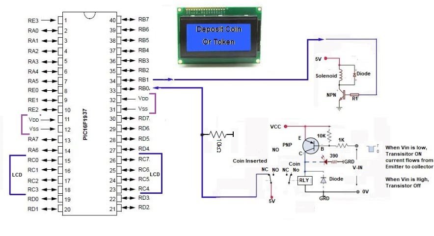

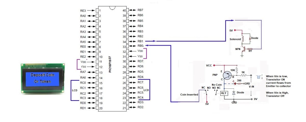

The summary is the Port B1 incoming signal is Logic 0 .
Step 1. With B1 is High Logic 1 (From a 10K resistor to VCC)
Step 2 Display text on the LCD
Step 3 ----- Trying to trigger B1
Step 4 -- Trigger on B1 from Logic 1 to Logic 0.

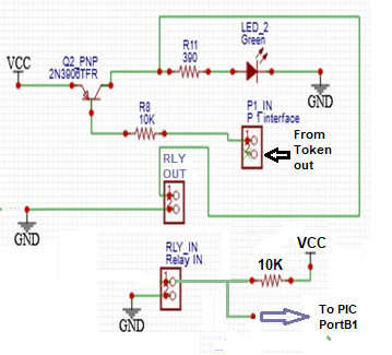

Step 5 - When B1 goes Low I would then run code to send a 120ms pulse to a Relay to control the Solenoid on Port B0
My question is how can I run the Solenoid code with out a trigger B1.
I can past a drawing if that helps.
The trigger from the outside hardware coming into B1 is only about 5ms on/off. This is what I could detect while The LCD is running text to Trigger and run the solenoid code.
My research indicates B1 is a IOC port possible to make a trigger just not sure how to detect ? Maybe fellow members of flowcode 6 have Ideas.
I tried the Intercept options but nothing worked. I did notice I can see the Port B1 change if I don't right to much text on the LCD.

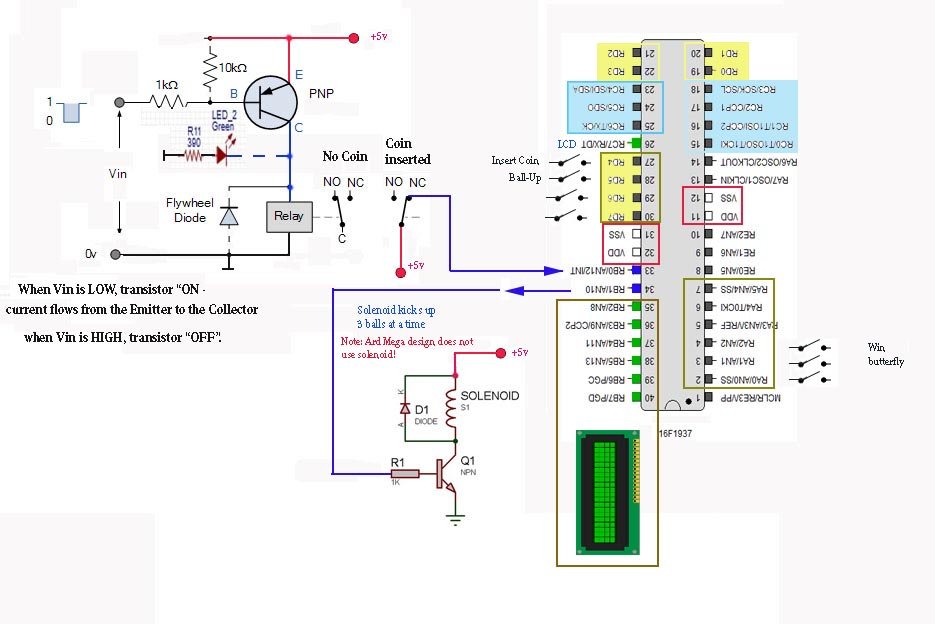

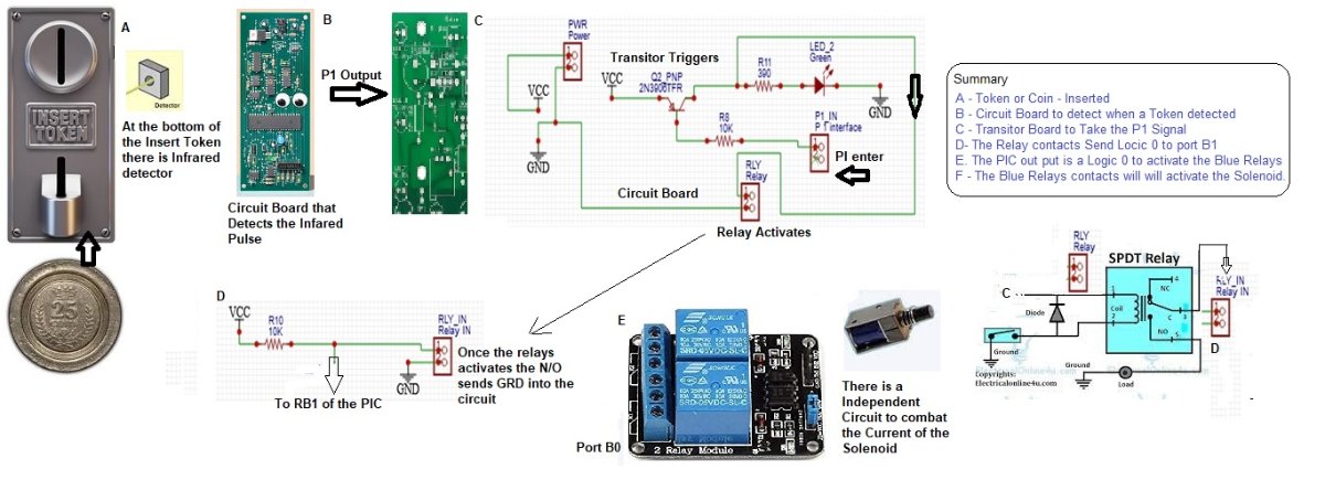

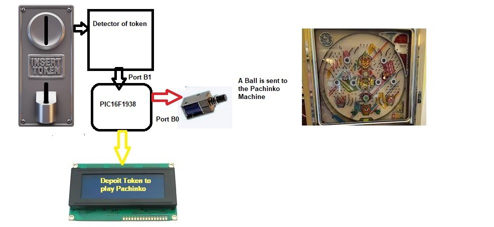

When a Token is put in the coin shut it falls out the bottom by to Infrared detectors that send a pulse to a PNP transistor and a 5v relay sends a Grd (Logic 0) to the PIC16F1937
In the PIC16F1937 I list procedure for game players to put in a token and I was trying to get the PIC to trigger on B1 to trigger a solenoid offer the Servo in my Flowcode 40.
Hope the picture helps.
John

I have really appreciated the Flowcode 40 version 8.
Question
A) Does your relay has NO and NC contacts? - The relay is NO until the P1 Input goes low from the coin detector.
B) Looks like you have the Pachinko machine. - Yes
C) Can I ask you what model is it? Its a 1977 - Sanko
D) Do you try to repair it or completely change the electronics? - Its all mechanical - I'm adding a ramp inside to dispense 45 game balls. I need the PIC to send 3 pulse to send 3 winnings in the pachinko will dispense 45 game balls. I have ordered a solenoid that will do the task if I can get the PIC to detect when the Relay activates
I changed to the PortB0 as you indicated but it won't trigger to activate the solenoid.
I have added the solenoid to your design Tried and tried to get the trigger but no luck. Viktor do you have a Pachinko Machine ?
John

No, I don't have a Pachinko machine, but read about it and consider your project as a good one.
An electronics + fun = a very good project.
You wrote: PIC to send 3 pulse to send 3 winnings in the pachinko will dispense 45 game balls.
Can you please give a bit more information.
About relay: what happens when relay is activated?
About solenoid: what activates solenoid? Does the user do it? How fast solenoid should be?
Does it work constantly? What stops it?
Would be great if you write something like:
If Coin is inserted

I hope This picture will help I can change the Port On Item (D) to RB0 to help with trigger.
The Item D is the input that Is Logic 0 input
The input B0 is like a Push Button Example
The solenoid is mounted in the back of the Pachinko machine and pushes a 3 balls at 120ms interval to trigger 45 games balls
So in the PIC40 design
1. Look for B0 at any time in displaying the info on the LCD
2. When B0 is detected the Solenoid will be is a relay driven at 120ms on then off just Designing a Solenoid in the PIC 40 for reference.
3. The Hard part is how to detect B0 action at any time ?
John

The Circuit boards for the Photo diode and the P1 were from a earlier projects for a Pinball Machine I worked on. I just reused the Interface boards.
The major Hill is getting the PIC to detect B0 in the PIC40 during a LCD message with a 5-10ms Relay Ground to B0.
Maybe when I figure out or have others help I might be able to use P1 into the B0 port ?

When coin is inserted, the transistor base goes LOW, the relay -> On,
NO -> disconnects.
NC-> connects PIC B0 to the ground? Is it a good idea? Maybe better to connect B0 to +5v?
In Ard Mega design the +5v supplied to MC pin.
Solenoid question.
Matrix flowcode solenoid tutorial suggests to connect the solenoid via transistor (check the diagram).
Note: Ard Mega design doesn't use solenoid.

1. On the PNP won't the relay be on for say 5ms sending a Logic 1 to BO ?
2. How to detect when B0 is high when sending info to the LCD or ( SSD1306 )
will play on the bread board and see how it works.

Enjoying these posts and your project appears to have caught the interest of many
As per a previous post, the INT0 pin is Port B0 so you need to move anything else you have assigned to that pin elsewhere. Viktor's diagram has the display on Port B2-B7 so B0 is free to detect the coins.
The INT0 interrupt can be defined to trigger on a rising or falling pulse (rising in Viktor's HW example) however the pin needs to be held low to prevent it floating via a resistor.

Re: How to detect when B0 is high
Ard Mega has D4 pin connected to relay (not B0).
PIC has B0 connected to relay contact.
I am not sure why do you ask that.
As in FC6/8 switch represents the relay NC contact, the SwCoin or SwRelay does the job -> it detects the B0 state.
I changed the label of this switch from SwCoin to SwRelay for easy understanding.
coin_state = SwRelay::ReadState()

Please pay attention to chipfryer27 note about the B0 pin state.
It need the 10k resistor (added to schematic).
You have to click on 'thank you' btn for chipfryer27.

I agree with Viktor, a picture of the machine would be nice to see. As a child on holiday (many) years ago I used to play similar in the very under-equipped amusement arcades. One venue even had pre-decimalisation machines and you had to buy "old" currency to use, at inflated prices. Probably worth a fortune today if they survived.
Viktor raises a good question as to how you will count the number of balls though. Is it enough to just assume three have been issued?
