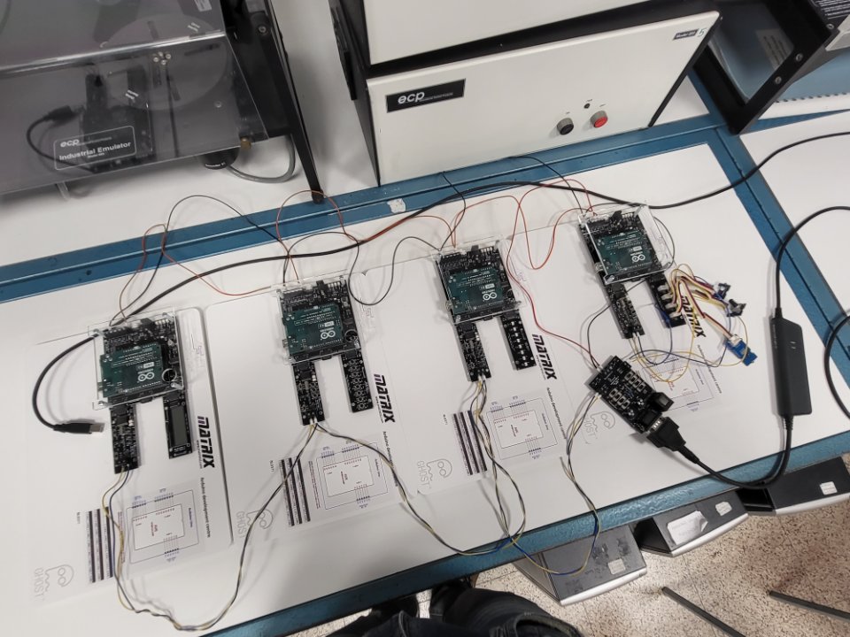

The picture of the setup is attached to this message for better understanding. After downloading the drivers from the resource file and installation, I connected the USB cable to port A of the arduino as seen in the picture then on the device manager, the port for adruino is recognised but there is still issue with the USB which is still the same problem

Re: Interfacing flowcode program on adruino BL0055 eblock2 board
This is the setup
With Flowcode closed and the USB lead plugged directly into the Arduino, it should show up within the windows device manager.
Check to see what the com port number is and then open your project in Flowcode.
Within your Flowcode project select Build > Project options and make sure that the correct com port is selected for Programmer options (General Options tab if Flowcode v8)
What version of Flowcode version are you using?
If after you have done that, and if you still have an issue.
Can you please post your .fcfx, .c and,msg files and we can see if we can investigate what your issue is.
