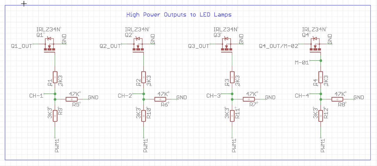

The LED Lamp continues to flicker while dimming with an LDR. The LED Lamp is used for road works and is equipped with numerous "lenses". This allows you to clearly see every flicker. Of course you don't see these flickers on a 5mm LED.
Four of these LED lamps are needed for this project, so also four outputs on the PCB.
I myself have the idea that a direct PWM solution will not work with this type of LED lamp.
The specs of this lamp are 12V / 940mA.

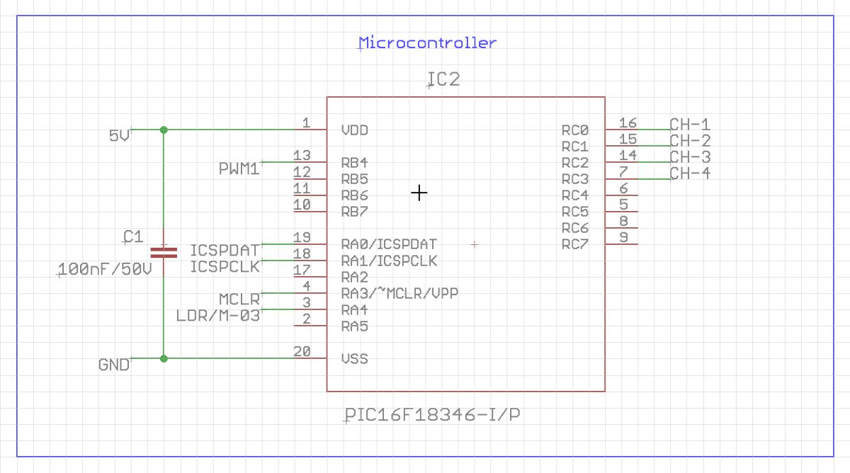

These are the associated hardware schematics
I already changed the PWM Prescaler from 16 to 1 which gives me a Frequency of 16KHz. Flickering is still visible.

I just replaced the LDR with a potentiometer. The flickering is still there. So it must have something to do with PWM and these LED lamps.
I think we should just forget about the whole PWM thing. What is a good solution to do this with an adjustable power source?
Are ready-made ICs available for this purpose?
The specs of the LAMP:
12V / 940mA
Each LED lamp has its own MOSFET (Logic Level IRLZ34N) The circuit diagram is simple:
ON: LED 1 and 2: 1 second
OFF: half second
ON: LED 3 and 4: 1 second
OFF: half second
Repeat
The LDR is an NORPS-12 with a 10K resistor.

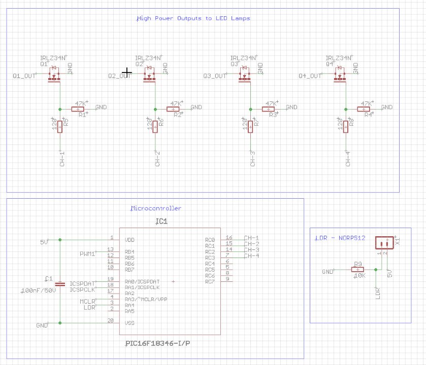

I've come a bit further with this LED Driver. I started from scratch with both the schematic and the flowchart.
I am now using the RCD-24-0.70 (max 700mA) for testing. The LED lamp has a specification of 12V/940mA. So far it looks perfect. No more flickering.
I used the following ports of the LED Driver:
PWM Dimming and ON/OFF Control for switching the LED Lamp on and off (CH1)
Analog Dimming Control for dimming. Via PWM -> Filter -> Analog (PWM-DIM)
I want to use the RCD-24-1.00 and it can handle up to 1000mA. But this is too much. Max 880mA control would be nice.
Can this be done through settings in the flowchart?

You also received a schematic as it is now on my breadboard.
Thanks for helping me ! :D

The target chip is an: PIC16F18346
ADC is 10Bit
The LDR is an NORPS-12 - https://www.farnell.com/datasheets/3759787.pdf
You have my schematic and the flowchart is above in this topic.

I therefore started again with the IRLZ34N Logic Level Mosfet. This should also be flicker free.
Just to be clear:
I have four LED lamps that have to dim via an LDR when it gets dark. These must also turn on and off at a certain frequency. The dimming must be from 100% to about 60%.
Attached is a basic schematic of the hardware I have now and a piece of flowchart that I use as a base. The lamps do not switch on and off yet and that is where the problem lies. How do I do this?
The LDR does work if I connect the lamp to the PWM output.
I don't understand how to dim the four outputs to the lamps via an LDR and PWM. It seems very simple… 
How can I have the readout from the LDR go to the lamps? I must be able to say somewhere in the flowchart to the LED lamp; Ok, you go on and off and with the value that the LDR gives.
Please help me!
LDR - IRLZ34N - ON-OFF.fcfx
(10.86 KiB) Downloaded 462 times

I assume that when C0 is on you want the PWM output to be active at whatever Duty Cycle, and when C0 is off you want the PWM disabled.
One way to do that is to just set the Duty Cycle to zero straight after making C0 go off.
LDR - IRLZ34N - ON-OFF_disable.fcfx
(10.86 KiB) Downloaded 494 times
In you chart you are using the potentiometer to create the value for the Duty Cycle. This works, so just replace this with your LDR.
Most PICs have at least two PWMs so enable these to operate at whatever frequency. The output pin(s) can feed more than one FET so you could have PWM1 feeding two FETS, powering LED 1 & 2, and PWM2 feeding two FETs powering LED 3 & 4.
Whatever happens on PWM1 will now control LED 1 & 2
Whatever happens on PWM2 will now control LED 3 & 4
To flash alternatively, say for one second you could
Set Duty Cycle of PWM1 to ADCvalue and PWM2 to zero
Wait one second
Set Duty Cycle of PWM2 to ADCvalue and PWM1 to zero
Wait one second
Repeat
Every minute or so update the ADCvalue based on LDR.
Alternatively just have a PWM operate the FETs, but have another FET switch the actual 12v feed to LED string 1&2, and another for string 3&4. These can simply be controlled by any free pins.

I am using the PIC16F18346 (20-PIN). In Flowcode I see there are 4 possibilities to use for PWM. Channel 1 to 4. In the datasheet of this PIC I also see four CCP channels. Can I use all four for PWM 1 to 4?
The other option is a good one. Use a second mosfet to drive the 12V. I'm going to take a look at this too.

Yes, you can use all four PWM channels. If you set them all to run from the same timer then they will each have the same frequency but can be independently controlled (if desired).
So if running on Timer 2 set for 1KHz then each PWM channel would be set for 1KHz, but each could have different Duty Cycles. PWM1 = 25% / PWM2 = 50% / PWM3 = 75% / PWM4 = 100% although you will probably have them all set the same.
