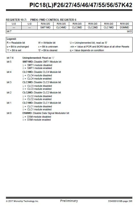

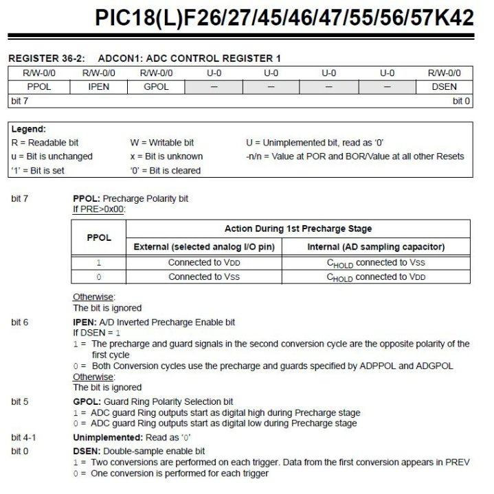

Being honest I've never used the -Vref option before, but from p296 of the PIC18F46K42 datasheet it looks like you need to set the ADCON1 register to 0x05 (0b00000101). Bits 3-2 set +Vref with bits 1-0 setting -Vref
In a C-Code block include ADCON1=0x05;
Let me know how you get on.

1. In the page 296 i found Peripheral Module Disable register only.
2. ADCON1 having only pre-configuration for ADC Precharge controls
3. ADREF register at page 622 of datasheet having that configuration. But don't know how to insert this piece of code effectively.

Clearly I've opened up the wrong document. I have a folder containing PIC datasheets and I must have inadvertently opened up the wrong one :oops:
From the correct one, I'd agree with you in that ADREF should be set at 0x10 by adding a C-Code block containing ADREF=0x10;
