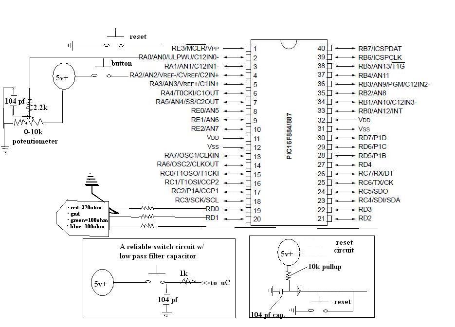

Re: Look Up Tables using Flowcode and Microsoft Excel
I have a few questions for those experienced with using look up tables in reference to the program posted above.
1.I am having trouble understanding the way operation occurs between flowcode and the look up table. Does flowcode actually examine the file 'SIN LUT.xls', retrieve the string of values, and then insert the string into the project during compilation? For example, If I changed an X or Y value in the SIN_LUT.xls spreadsheet and then compiled one of the included programs will flowcode examine the excel spreadsheet and put the current state of the "Complete Array Declaration String" into the program. (sort of like how a library or linker file works in mplab)?
---If flowcode doesn't operate in the above manner above (and I don't think it does) is it correct to think of the spreadsheet as simply a tool used to calculate the string of values and concacenate/chain them into a form that flowcode can use?....Therefore, the only thing that flowcode examines is the data that the user paste in the supplementary code box and there is no data exchange between the excel sheet and flowcode?
2. I am trying to build a program that will control the duty cycle of an RGB LED using a look up table system like ben has but i am unsure how to apply to a pretty cool rgb led LUT i found online(attached below).
--My idea was to use a potentiometer and ADC to return a value for 'Hue' ranging from 0-19 and use 5 momentary action pushbuttons to select color from darker to lighter as reflected in the table. So if I turned the potentiometer to a position that returned a value of 9 and also hit the first button returning a brightness value of 1, I need my program to return the data values for red, green, blue found in the chart where row 9 column 1 intersect which is
"r= 0 g=255 b=192"...... these values will then be used to set the PWM duty cycle for the led until changed.
For the life of me I cannot see how to make an array or string that could return the appropriate values for each color. I thought about storing the data into the eeprom but experimented and could not find a way to find each location. Even if there was only one column for the brightness setting I have trouble understanding how to make an array or string that returns r, g, b. I understand how a basic array works but is it possible to build arrays within arrays within strings or some other odd combination of such that interrelates data table.
If BUTTON = 1 ;
PWM_DUTY_RED = COLUMN1[RED[ROW[POTENTIOMETER_RETURN[=9]]] ;
PWM_DUTY_BLUE= COLUMN1[GREEN[ROW[POTENTIOMETER_RETURN[=9]]] ;
PWM_DUTY_GREEN= COLUMN1[BLUE[ROW[POTENTIOMETER_RETURN[=9]]] ;
From here I would need to build arrays/strings that would hold the data for all the columns, rows and so on.
Any advice, ideas or suggestions or solutions are welcome. I'm at a dead end for now when it comes to using the RGB lookup table and have no idea how to form an effecient program with it. btw.....there is some kind of macro in the attached table that the author made that can look up a color. I have no idea how it works but I bet it could be used. I found the LUT on the microchip forums
If BUTTON = 1 ;
The look up table will not be a problem, I can help you with that.
I'm not sure if only one LED on at a time will give you the same lighting effect as all three on at the same time. There will be a persistence of vision, but if you set value of 0, 255 and 192, do you get correct blue. Then alter values to 255,192 and 64. do you get correct shade of orange. At this stage do one step at a time, you do not need the pot or switch connected. Just manually set values and send to target.
Take a look here:
http://www.matrixmultimedia.com/mmforum ... 21&p=16827
and here:
http://www.matrixmultimedia.com/mmforum ... =26&t=7652
Between the there methods you have, choose one which would be best to use.
With the last link, you do not need a miac it will still give you an idea.
When you have established a method and created a Flowchart that just works by manually setting three numbers for RGB. Add the pot and switches.
then upload to forum, and I will sort the look-up table side out for you.
Or if you want I will post how I would created LUT along with a formula to access correct numbers, so you can add it yourself.
Take a look here:
and here:
I have created a way to enter the LUT method.
You will need to copy Red, Green and Blue boxes, and paste each in the supplementary code window ('View', 'Project Options' then select 'Use supplementary code')
Formula 1 is entered in a calculation component
Formulas 2 - 4 are entered in a C component
Brightness variable in Formula 1 is determined by which switch is pressed.
Switch 1 for lowest brightness so Brightness=1
Switch 2 for a higher brightness so Brightness=2
Note the look up tables are using first 4 switches only. So formulas 2 - 4 are only accessed if switches 1 - 4 are pressed.
If switch 5 is pressed, then just use a decision Branch to set PWM_RED, PWM_GREEN & PWM_BLUE TO 255.
E.g IF SWITCH 5 = 1
THEN PWM_RED=255
PWM_GREEN =255
PWM_BLUE = 255.
ELSE
ADC0=((19*ADC0/255)+Brightness*20)-20
FCV_PWM_RED= red_brightness[FCV_ADC0];
FCV_PWM_GREEN= green_brightness[FCV_ADC0];
FCV_PWM_BLUE= blue_brightness[FCV_ADC0];
Hope this has helped enough for you to complete your project.
I am quite interested in this project. Maybe somebody have scheme and PCB layout ?
Here is an extremely simplified version of the final program. It utilizes one pushbutton that cycles through the different brightness settings. I have setup this program in a variety of formats where 1-5 pushbuttons are used, several rgb led's are powered,etc....and they have all performed well using this template.
The best part about this program is its' high resolution. You can adjust the on duty cycle from 0-255 out of a 255 length period.
This program runs flawlessly on an 18f4685 and has a few hiccups on the 16f887 every so often. The hiccups that you encounter ARE NOT a problem with the program, but a problem with values in the look up table and uC you are using. If you play around with the LUT values you will hopefully be able to smooth out any color/flicker issues that arise with your uC, I was able to. Some chips will have issues some will not...The reason for this is beyond me.
I was surprised to find this program runs best without using interrupts as in the mood_light bit bang pwm demo program referenced by medelec. I tried numerous methods for implementing this and found the version below run it the best.
Thanks again medelec for helping me figure all of this out.
Hopfully this program and circuit will help somebody else learn how implement LUT's or perhaps drive an rgb led.

Probably reason is timing of interrupt. Your program works fine now, but if you add any more functions, then timing of LED lighting will be affected. I will see if I can match them up so timing LEDS or on/off are the same with and without using interrupt just to see. It's great that you have a working version.zen wrote:I was surprised to find this program runs best without using interrupts as in the mood_light bit bang pwm demo program referenced by medelec. I tried numerous methods for implementing this and found the version below run it the best.
Your welcome. It's great that you and other members post what you have got working, so people can lean by example. Thanks for that.zen wrote:Thanks again medelec for helping me figure all of this out.
Re connection of switches to i/p ports.
It is not recommended to leave and i/p floating See Fig1. This is because interference/noise etc. can make the i/p rise to A voltage which is either above logic 1 voltage, or in between logic 0 and logic 1. If you did not want to connect a pull-up or pull down resistor, then you can use a port that can be configured for internal weak pull-ups.
Value of resistor is a trade off between keeping voltage near to VDD or VSS and current drawn. E.g if value is too high, then becomes less effective in higher electrical noise environment, but current flow is less. If value is too low, then too much current is drawn so can cause loading of supply, or current rating of chip to be exceeded. Its hobsons choice, but 10K I believe is a fair compromise but can use 1K - 100K. Other people may have different preferences.

I was looking at Zen's scheme and I am wondering, if I would make it and programmed the chip with your program, would it work ? as far is a saw on the internet everywhere transistors is being used in led output. so i am quite confused.

Transistors are used if you want to drive more current through LED's than microcontroller can supply (max current supplied/source = 25mA or a total of 250mA) . E.g Peak of more than 25mA per pin or 250mA in total, or where several LEDs are in series, so require a higher voltage source than 5V microcontrollers can supply. With zen's circuit.
Since only using 3 LEDs with series resistors to limit current through each LED (max current of standard LEDS usually about 20mA) transistors to drive LED's will not be required.
So yes it would work.

thank you for your help. For the first time I would use only three small leds or one with four contacts, just to try how everything works. I have few other questions, maybe you have zens circuit drawn with some software? Maybe it would help me to understand all connections. Maybe some other chip could be used instead of 16f884 and 16f887?
