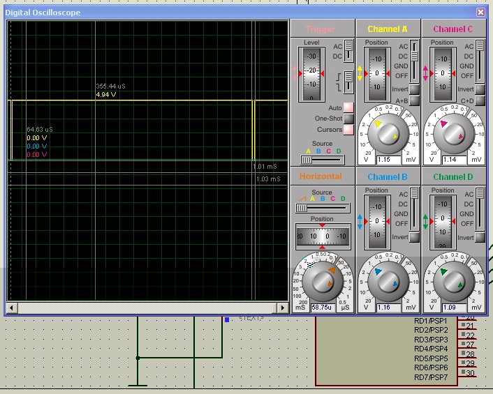

this is a servo position control program done by me....i don't know if it is correct so i hope someone check it for me and tell me if there is a mistake or and change that should be done...
the program will simply change the position of the servo when turning CW to turning CCW when reaching some defined position here is "100" just theoretically it means that it will reach 180 degrees in one position and then will go back and rotate another 180 degrees in the other side....any suggestions of how to develop this program???

Hi khaled yasin , i think you may need to start your PWM servo experimenting using the already available
programs from this forum, it is only my opinion mind you, i think your tackling your programing the wrong way ...too many jumps... using the program length to govern the speed of pulses etc.... I have put your program into proteus and took a screen grab of the oscilloscope. You can see that the timing is all wrong.
best of luck.
best of luck.
- screen grab1.jpg (109.5 KiB) Viewed 6438 times
