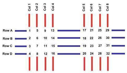

Looks like you're right... one keypad per port per flowchart, (for the real world) tried splitting the keypad... Rows on one port and Columns on another... some weird results! I thought i could get away with fewer I/O, as my Keypad Bus is limited to 16 lines and i have to multiplex a led array on those keypads aswell. What i gather from scouting the forums, it doesn't look like we will have custom keypads greater than 4x4.
What i don't get, is why in simulation, the 2x Keypad Matrix works?
Thanx for the mod.

Keypad Matrix.jpg (19.61 KiB) Viewed 7137 times
