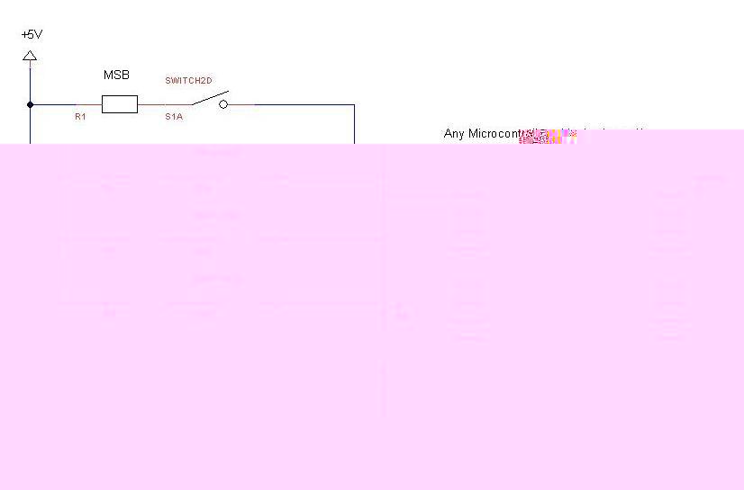

Has any one had success with there own values for R1, R2, R3, R4 & R5.
I would assume binary weighted would be best, but LSB can’t be too high.
Best values would produce a difference of at least 200mV with all permutations.
I can mange 200mV with most but with one permutation there is only a difference of 50mV.
I am looking to have more than one switch closed at a time.

Thanks Ben. I Did think of R2R fist, but ruled it out since I am using a SPST dip switch. Don't R2R need a SPDTswitch i.e switch to either o/p or short resistor to ground? Refering to the link you posted: If you think about it, bits o/p from a Microcontroller will be either at +5V or GND when using as DAC.
If I am wrong and R2R can use SPST, then I will defiantly use that method!

msb lsb Voltage
0 0 0 0 0
0 0 0 1 0.493
0 0 1 0 0.704
0 0 1 1 0.925
0 1 0 0 0.986
0 1 0 1 1.234
0 1 1 0 1.312
0 1 1 1 1.441
1 0 0 0 1.455
1 0 0 1 1.767
1 0 1 0 1.877
1 0 1 1 2.025
1 1 0 0 2.016 < Problem
1 1 0 1 2.187
1 1 1 0 2.23
1 1 1 1 2.321
R=10k 2R=20k
It nearly works! Have highlighted where the problem one is.
Going back to previous method, just trying to work out which resistors are best values. I know best is R 2R 4R 8R 16R etc. but is the initial R value which would make not make R too large. Finally its what value to make R5? If too low will have more significant effect on 16R.

I've had a look at this and the best I can come up with is a minimum difference of 70mV. To do this, I used the resistors as follows:
R1 = 2k2
R2 = 4k7
R3 = 10k
R4 = 22k
R5 = 1k
Things can be drastically improved if the network of resistors is powered off 10V instead of 5V. Using the same resistor values, the minimum difference becomes 140mV.
A spreadsheet is attached. I hope I got the math(s) right!
R1 = 2k2
R2 = 4k7
R3 = 10k
R4 = 22k
R5 = 1k

Thank you to both of you for your replies. I appreciate it.
Especially thanks to Steve for taking the time to produce a useful spreadsheet.
I will go the 10V supply route, since alreay have a 10V supply to drive 2 EC motors.

I have just completed a test on real hardware. Measured actual resistor values, and entered them into spreadsheet.
Steve your maths is spot on! I have attached results for anyone to view.
