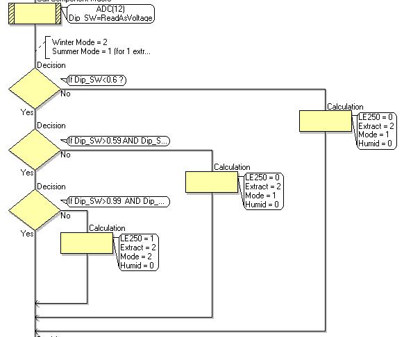

Here is my 1st attempt. Im sure there could be a better way using calulations! If more than one unit is produced with a tolerence in components, and power supply, without a window, one unit might work, but the next one may not work.

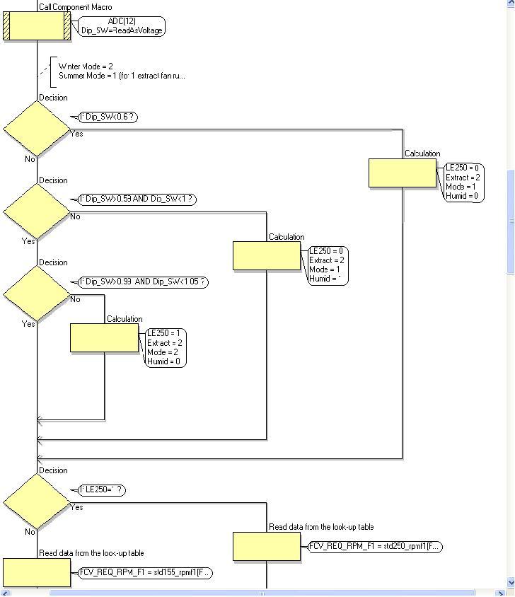

Zoomed in so more of calulations can be seen. Also correct a couple of things.

Thanks Steve, What you posted last, takes a bit of working out. In the mean time.I have got a working version. do think yours or Ben's way is simpler?
I have posted results form a different set of resistors and completed a Flowchart based on results.
