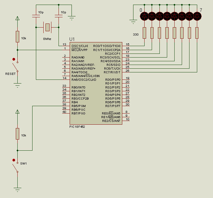

Consider this schematic:
Toggling SW1 will trigger a PORTB change on RB5, which will increment the binary count on the leds.

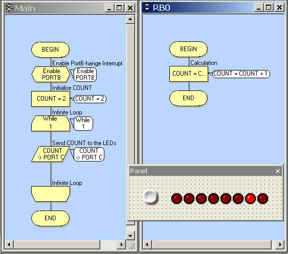

This is the Flowcode V4 program (based on a tutorial file from V3):
My problem is this: The program seems ok in Flowcode and it simulates ok.
In real life however it doesn't work. No reaction from the led's.

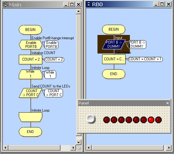

If I add 1 input icon as shown in the next program, where I simply read the PORTB into a variable DUMMY, everything works fine in Flowcode AND in real life.
What is the reason behind it and is there perhaps a better way?

The PortB Input icon is converting the I/O pins on PortB to inputs.
Before this the I/O pins would have been defaulted to outputs on startup which is why the original program was not working correctly.
You could instead have a single dummy read of PortB right before your interrupt enable icon and this would also allow your program to run correctly.

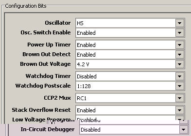

Attached you can find my configuration settings. Maybe there is something wrong.
Rgds,
