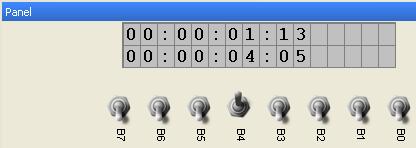

Re: Dual Timer
I have created a dual stop watch with V4
See: http://www.matrixmultimedia.com/mmforum ... 30&p=14586
Although there are two times. one on upper part of 2x16 LCD and one on lower part of LCD. They can be poled so both stopwatches could count independently at thesame time. only difference is you won't' need the 100's second.
I could help you to create V3. The secret in making it work is using a Variable set for array[2]
To help you on your way, I will post a screen shot when get some time today.

Re: Dual Timer
Here as promised:
- (233.36 KiB) Downloaded 4911 times
- LCD Display Stopwatch.JPG (10.75 KiB) Viewed 14484 times

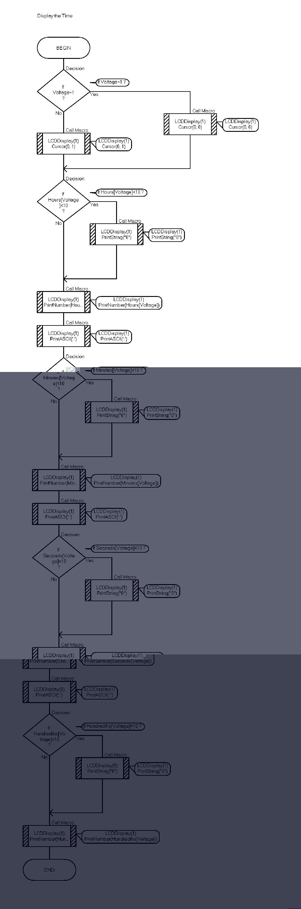

Re: Dual Timer
Just had a quick look.
A few things spring to mind.
On your 1st post you stated Timer A 10:30 (10 minutes and 30 seconds). But you only allow entry
of 3 digits. This means you can max 999= 9 Min's and 99 seconds.
What about putting valid time entry routine, which won't allow you to enter 60 seconds or above?
On your display you could have T1=
instead of Timer A =
That would give you more room. E.g
T1=02:30
T2=10:32
It is minutes and seconds count down. As you would know there are 60 seconds in 1 min. so if enter
102 then sequence should go 1:02,1:01,1:00,0:59,0:58..etc
not 102,101,100, 990 980 etc. The 0 is on the end because you have not over written the third digit with a space.
There is no routine in place to wait for key pad release before allowing entry of next number.
Keys will be read very fast! so if u press 3 briefly, then 333 will be entered!
Only one line of display is shown until 1st timer finished. why not have both timers shown form the start.
There should be an option to change time entered at any point. If not you will have to keep disconnecting power to enter new time.

Re: Dual Timer
DEar Sir:
I re-work using the clock of FC examples, and I made some modification the time can be set at 999 Sec = 16 Min + 40 Sec
Please check,
Armagon
Please check,
Armagon
