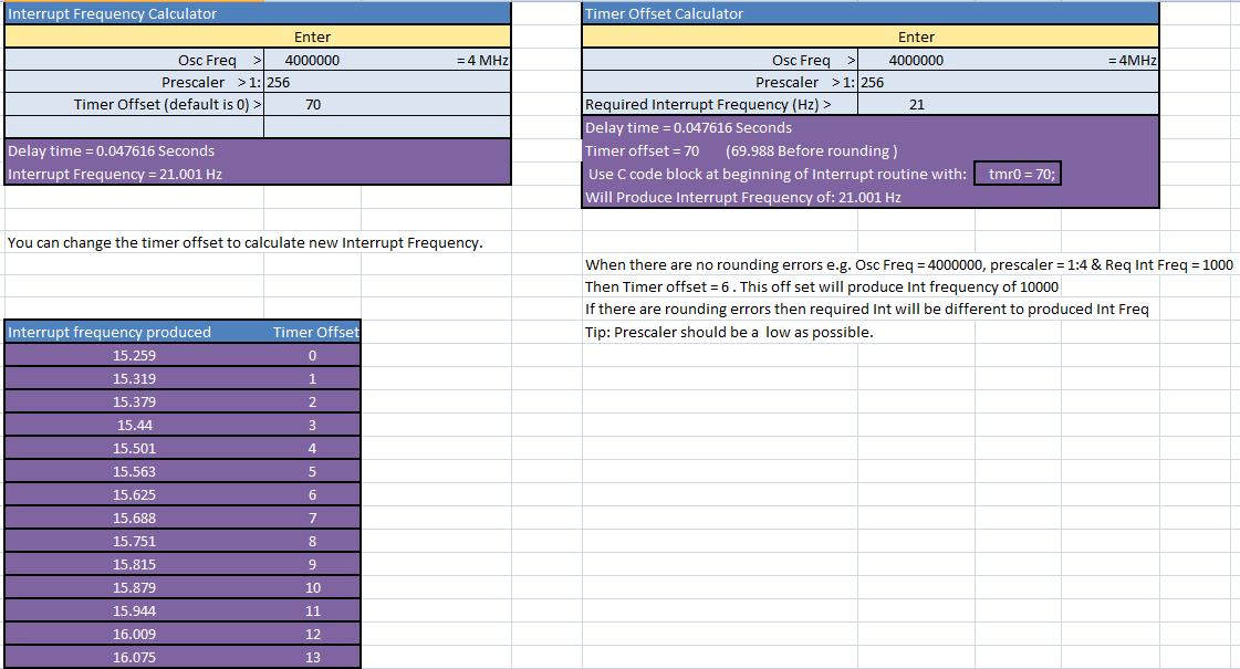

This is for people who using timer0 would like microcontrollers to interrupt at different frequency to those available.
E.g your microcontroller speed is 4MHz and you required an interrupt frequency of 1000Hz. You look at properties of interrupt to discover you only can have an interrupt at 976.53Hz with prescaler set at 1:4 or and interrupt at 1953.125Hz.
With attached calculator,It will show how to get that desired interrupt frequency to set at 1000Hz.
It won't work on all cases. This is because timer offsets can only have a whole number between 0 and 255 and the calculation result could be 120.53 for instance, and you can only enter 120 or 121 for offset. For that reason I have also included in the calculator offset if not a whole number and frequency of interrupt generated with the calculated offset since there are times these won't match 100%.
Hope this would come in useful. I created calculator for my new project, but I'd thought I'd share it.
Note: May sound obvious. But two points.
1) Calculator created in excel 2007, so if opened on a version prior to 2007, then colours will vary form attactached image.
2) All text within light grey areas are user inputs. All text within purple areas are calculated results.
Interrupt Frequency Calculator and Timer Offset Calculator

V3. Added Useful list of Interrupt frequencies produced for all Timer offset values from 0 - 255 at the set prescaler rate.

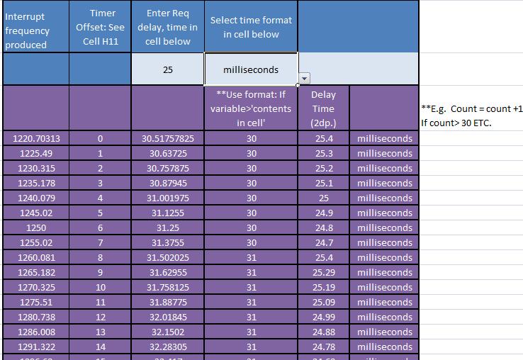

V4.
Added extra columns to calculate variable value required in interrupt macro for a given time delay. Untested. Comments for improvements or usability are welcome. Perhaps comments on the maths please, i.e. how accurate calculations are.
Thanks.
Thanks.

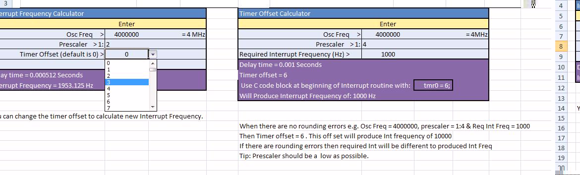

Re: Interrupt Frequency Calculator and Timer Offset Calculat
V5
Some minor cosmetic improvements.
Improve accuracy on updating timer values, thanks to sean for saying about += instead of just =.
Calculator on the right loads with same Osc Freq and Prescaler as entered on the left, so less data to enter.
Notice you can use calculator if require;
A interrupt frequency e.g 80Hz
or
A specific time delay using interrupts eg 300 seconds.
Also if require a particular delay, then delay given for all timer offsets (0-255)
or
