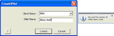

For every VNet there must be a VNet Owner that initiates group simulations and assigns the connections of the network. The creator of each VNet becomes the Owner of that VNet by default. To create a new VNet you first have to click on the VNet menu and select Create. If your Flowcode instance can successfully connect to the VNet server on the network, you will be presented with a dialog window shown below. You should enter a name for your VNet and a name for your Flowcode instance. It is important that your VNet name is unique on the server and is not already hosted by someone else. Clicking the create button starts up the VNet on the server and makes the VNet available to other Flowcode instances.

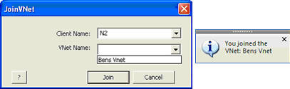

Now that you have started up a server, created a network and exposed some of the components over the VNet, we can start to join another Flowcode instance nodes to the VNet. In another instance of Flowcode either on the same PC or on a networked PC, set the VNet server߀™s IP address and click VNet and Join. From here you can enter a name for your Flowcode instance and also select the active VNet you wish to join. Make sure that your Flowcode instance is unique or otherwise you will not be able to join the VNet.

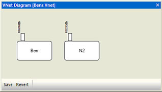

Once all nodes have been established onto the VNet you are ready to start wiring the nodes of available Flowcode instance together. The VNet owner instance can click on VNet and View Diagram to see the nodes currently attached the VNet. The nodes appear at the bottom of the window and can be clicked to be added on to the VNet diagram. Once the Flowcode instances are on the VNet Diagram they can be dragged around and rearranged to allow for more connectivity options. Shown below are the two VNet instances I created which both have RS232 nodes available.
By clicking on the RS232 node I can draw a line to the other RS232 node. Connection lines can have multiple points and can even branch in multiple directions to allow multiple nodes to be tied together.
When you have finished editing the VNet connections click the Save button to send the connections information to the VNet Server.

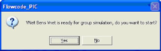

When every node in the VNet is ready for the group simulation to begin then the VNet owner will receive this message from the VNet Server.
Clicking Yes will start the simulation on every Flowcode instance connected to the VNet allowing the start up to be synchronised similar to plugging the power into a real life system.

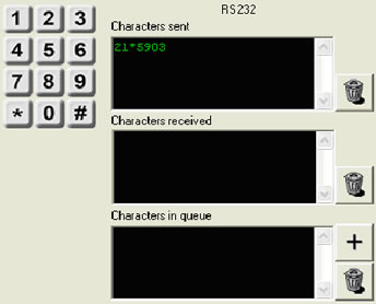

In the examples provided node 1 is constantly polling a keypad. When a key is pressed on the keypad the ASCII value for the key press is sent over the RS232 connection.

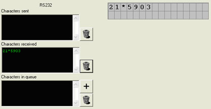

Node 2 simply listens to the RS232 for incoming data, if data is present then it gets printed onto the LCD screen.
