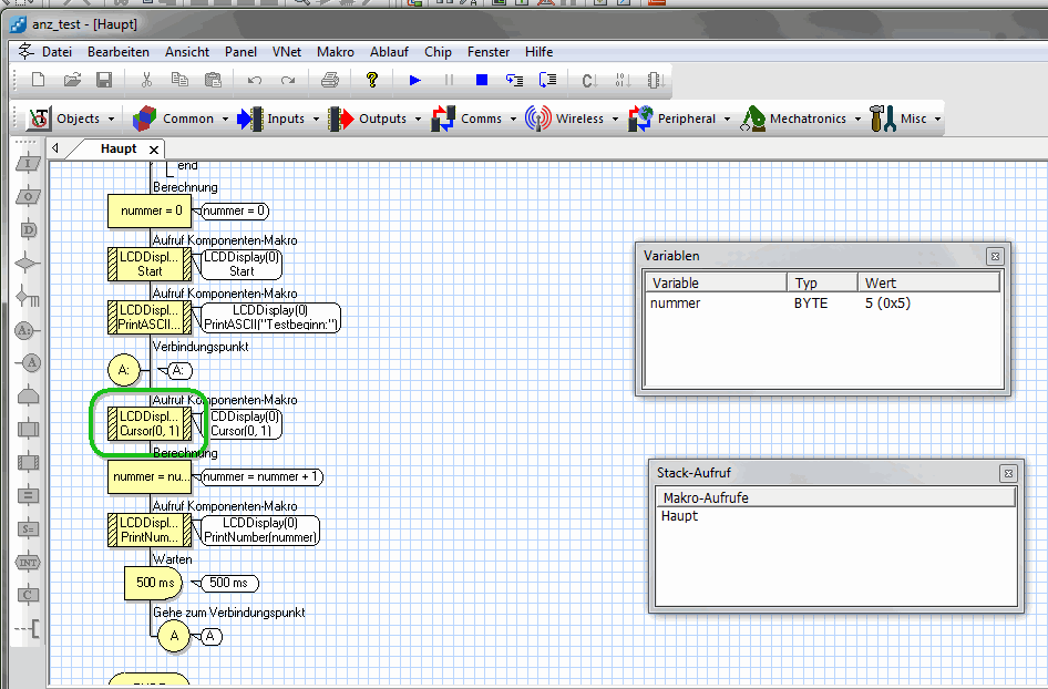

After these, i compile "anz_test" to chip with flowcode V3 and it works well.
if i do these with V4.1.1.55 , i have no effect on my real display,but v4 simulation work.
If i do these in ICD Mode it works but without display-reaction.
Every time i have compile in v4 (on all *.fcf file):
Caution: Delay inaccurrate: 'delay_10us', Delay overhead:0ms, Unit delay:0.0100708ms, Delay resolution:1 units
Caution: Delay inaccurrate: 'delay_ms', Delay overhead:0ms, Unit delay:1.00006ms, Delay resolution:1 units
Please help me.

Re: ICD Mode part 1
Hello Wolfgang
In ICD mode components no longer simulate. This is why the Flowcode simulation LCD is not responding.
Sorry to hear about your jumper problems, this sounds like the same problem that Medelec was having a while back.

Re: ICD Mode part 1
Hello Benj
Simulate the display works!
If the display is connect to port b all works ok.
After i connect the real display to port a,change settings to port a,on my board the display dont work after compile to chip in both mod`s!
regards Wolfgang
