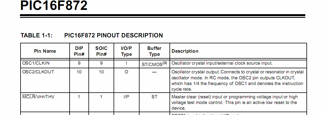

Normally on other microcontrollers, options to change pin 1 to input pin or MCLR pin is via Configuration settings.
This option is no available via PPP config.
So how can MCLR be changed in flowcode please?

Hello medelec35
The 16F872 pin 1 is only.......
Regards wolfgang

Ah yes of course. Pin 1 cannot be used as a standard i/p, that's why option is not there.
Reason why I asked question is reset was not clearing variables, count kept continuing. So I put a o/p high for 5 seconds every time device is reset, which was occurring.
