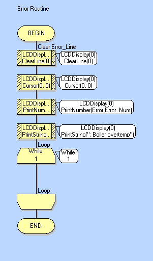

Something that still puzzles me is the behaviour of the watchdog in a deliberate end loop.
Suppose you have somewhere in your program an error routine like this (just an example):
The intention of this code is to stop the program from continuing in case of a critical error.
However, if the watchdog is on and the program has entered the endless loop in the error routine to prevent it from continuing, than the processor will be reset by the watchdog after some time. The result is that the errormessage is gone and that the errorsituation will repeat itself.
Is there is a possibility to switch the watchdog on and of during program execution?
Or is there a better way to handle this kind of situations?

Re: Watchdog
If it was me , I would place any critical testing like boiler temperature at the beginning of the program E.g A call to macro, as well as in the normal place. That way, If watchdog does reset program to beginning, then first thing program does is recheck the temperature, and shuts down heat power source (Gas electric etc) and displays error. If you have got a microcontroller with EEPROM, then error message then be stored in that as soon as it occurs. Then if watchdog or brownout resets program, then EEPROM contents can be retrieved at the start as well.
Sorry if not much help to you.
Re: Watchdog
The watchdog timer on a 18F452 is software configurable so if you have is disabled in the chip configuration you can later enable it in software by using the following line of C code.
set_bit(wdtcon, SWDTEN);
if your using v4.2 of Flowcode or later then the command is
st_bit(wdtcon, SWDTEN);
However Medelec's suggestions are probably better as that way the watchdog is always enabled.
