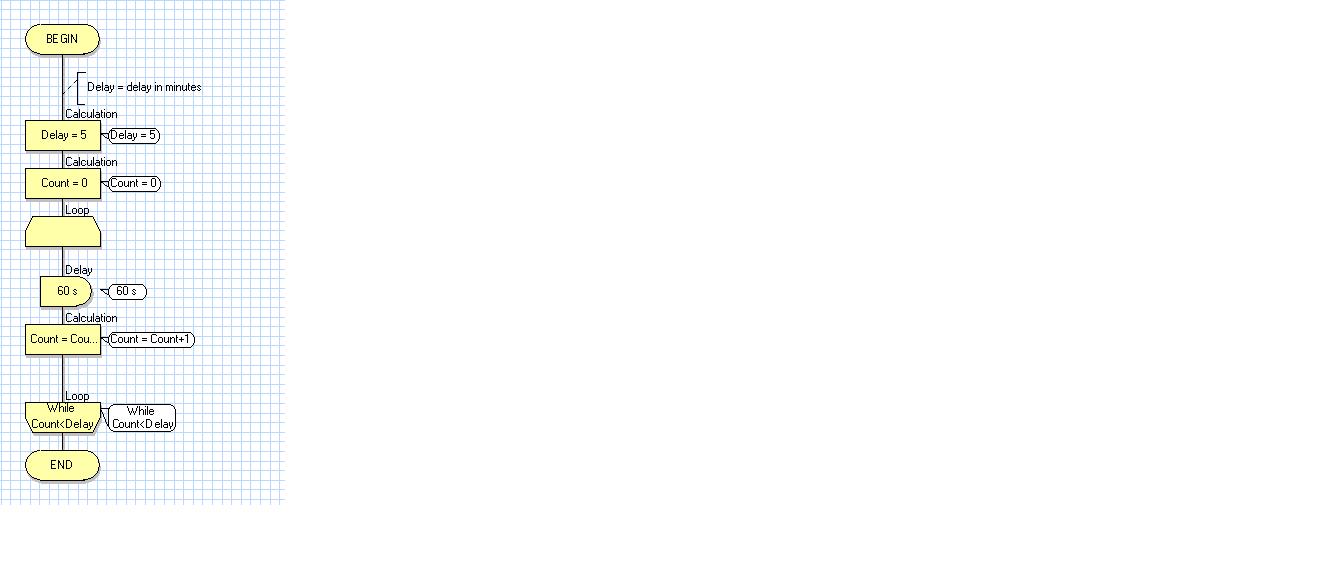

Since Flowcode only has delay time in Microseconds, Milliseconds or Seconds, here is a simple way to have time delays in minutes (1 - 32767 minutes).
It does not use any timers, just uses the seconds delay icon.
For those of you with non V4, I have posted a screen shot.
Minutes Delay.fcf
(3.5 KiB) Downloaded 638 times
(50.77 KiB) Downloaded 1810 times
