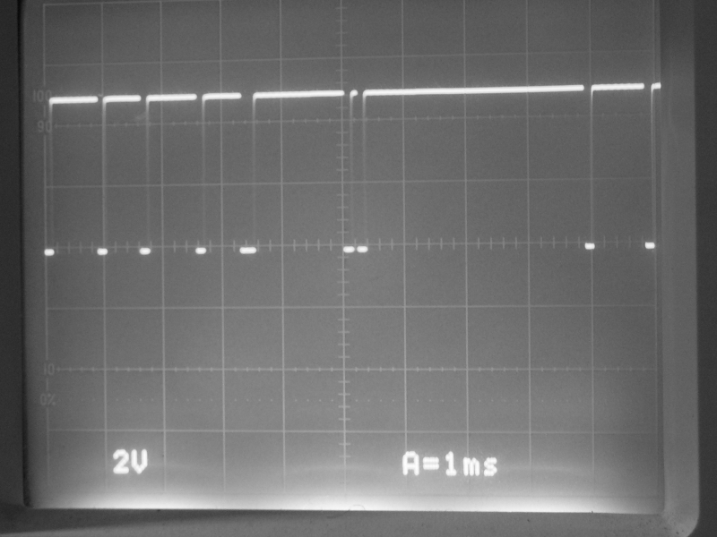

The sequence of the digital output has not been published, but with a scope, see picture, I found out that there are 4 bytes, repeated in a time frame of 84 bits. The 4 bytes are preceeded by a startbit β€1β€ and followed by a controlbit (β€1β€ for an even number of bits in the byte, else β€0β€). The total length is thus 10 bits followed by 6 bits β€0β€. Between the last control bit and the first start bit of the next sequence are 26 bits β€0β€.
There is one problem, the bit width is about 120 usec and the distance between two bits is about 104 usec. That means two bits β€1β€ will overlap and detection of these two bits simple by detection low-high and high-low is not possible. One must know the bit-width and the bit-distance first.
An example is given in the picture. High is β€0β€and low is β€1β€. The first byte is always 0x00, the second address-byte is in this case also 0x00, the third data-byte is in this case 0x80 (see overlap with the startbit) and the forth byte is a controlbyte (which I skip, because I do not know the mathematics for it). The peak at about 9 msec is the first startbit of the second sequence.

- 4 bytes 0x00, 0x00, 0x80 and 0x40 in a sequence of about 9 msec. "0"= 5V and "1"= 0V. See text for details

How I solved the problem. Using Flowcode can introduce delay time just by program steps used. The delay time is not known and will vary when changing the program.
The sampling of the 8 bits is simple realised by using interrupt time of 104 usec (19200 Hz). The start of the sampling is a problem. The first start bit (first peak in the figure) can easily be found. I varied a delay time before starting the bit-sampling procedure in a way that the first byte (which is always 0x00) will give after sampling the right value. If the delay time is to short or to long the byte found will be 0x80 (start bit detected) or 0x01(control bit detected). The realised delay time is a the mean value of the shortest and longest delay time which give as result 0x00. The value found is 145 usec.
Remark: This deviates about 20 usec from the theoretical value, due to (variable amount of) program steps and due to a possible deviation in sampling time from the microchip compared to the HE433-2/R used.
