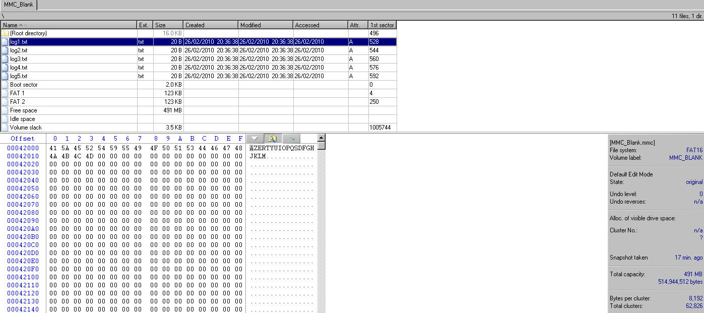

I want to create a datalogger on MMC card.
The idea is that every time the logger is restarted or reset, a new logfile is created in the root directory.
The attached program is a simplified version of the final program just to demonstrate my problem.
It creates 5 logliles ( LOG1.TXT, LOG2.TXT .... LOG5.TXT ) and it writes in every logfile some text ( AZERTYUIOPQSDFGHJKLM ).
After reading the MMC on pc, I noticed that the 5 logfiles are indeed created.

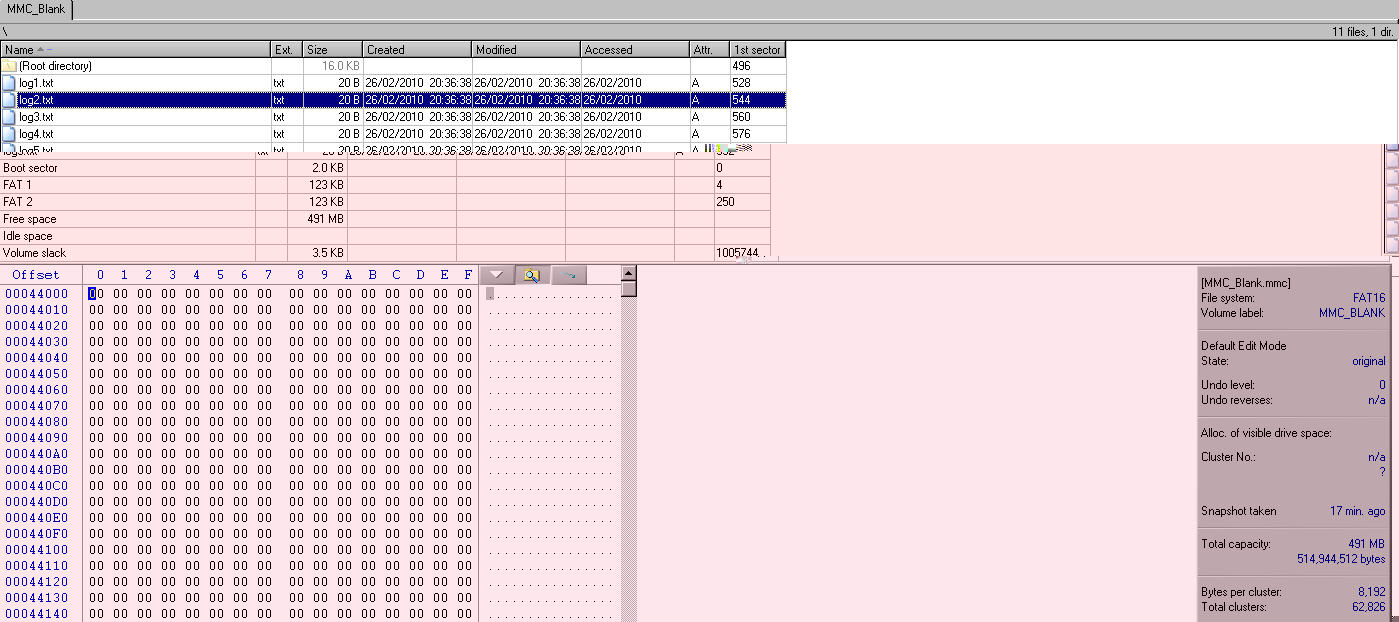

But only in file 1, 3 and 5 the data is written. In file 2 and 4, no data is written however the file lenghts of all files are equal.
Investigating the resulting MMC in Winhex shows that the MMC is formated with a clustersize of 0x2000, while the data is only written every 0x4000.
The problem is reproducable on another pc.
Only every second file contains data.
The MMC is formatted in XP SP3 as FAT16.
Any idea what is goiing on here?

When you formatted the card did you specify the sector size as 512 Bytes. If you do not do this then the embedded memory allocation will not work correctly. I am currently in the process of testing several different cards with the FAT component and hope to have a more conclusive list available soon. This is bacause some of the newer cards have a default sector size of 1024 and above.

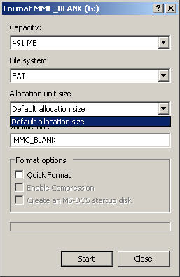

But unfortunatly XP Pro SP3 doesn't offer me the choise to format the MMC in another format as the default one.
