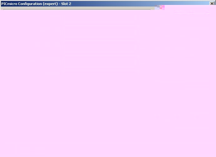

I found out that the CHIP settings should be HS instead of XT here:
for my HW to work (at least "work better" - still missing a little but I have to investegate that)
But in fact I have an EXTERNAL X-tal (to be honest a resonator !) - what does HS mean ?

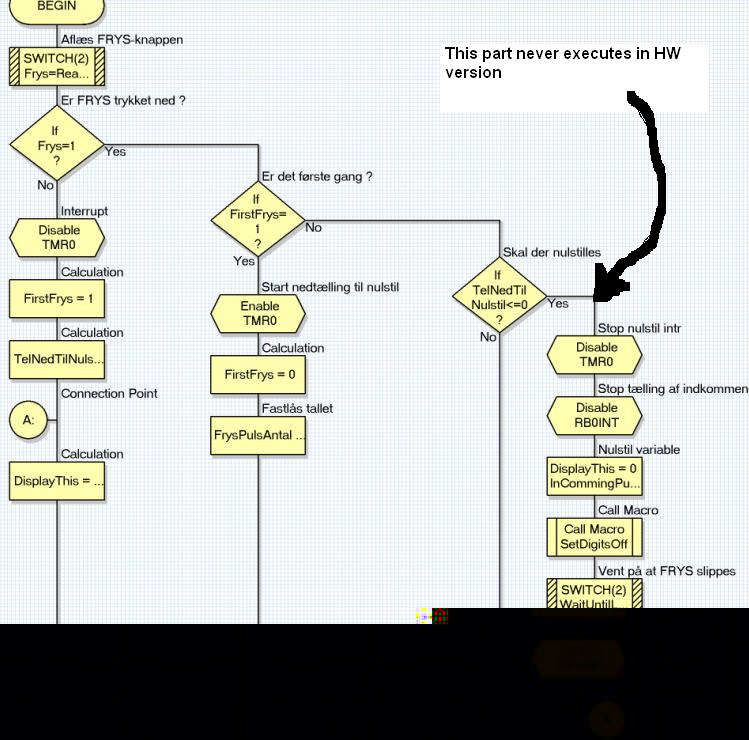

I have a problem left in my HW version !
The Flowcode is working fine and I can step through the flowchart and it's doing what it's supposed to do.
The "facility" I'm going for is 1 pushbutton for both "FREEZE" and "RESET TO ZERO" - when first pushed the display is freezed and when the button is HOLD DOWN for a while further the display is reset to zero - it works fine in Flowcode but NOT in HW !
Here is the flowchart i two parts:
(104.81 KiB) Downloaded 3148 times
PART 1.JPG (32.75 KiB) Viewed 12251 times
Any ideas of what goes wrong ?
Best regards
KSor, Denmark

Regarding your ISR and the "stack corruption" warning - it's because you are using the "switch" macro in the first one, and this has a reference to the "delay" function. You could try reading the pin directly instead using the "input" icon.
The "HS" is the required setting when using a crystal (or resonator) above 4Mhz - check the device datasheet for more info.

My problem now is that the branch marked with the arrow in my last post is NOT executed in my HW - it runs fine in Flowcode !
When a pushbutton is pushed, it should in the first place FREEZE the display with a counting result and if the button is HOLD DOWN a little longer, the display should reset to "0000" - and it does in Flowcode but not in HW.

Re: Running fine in Flowcode but not in HW ??
The problem may be due to the <=0 statement.
Is the variable a byte or an integer?
If it is a byte then you should be able to get away with =0.
If it is an int then the code should work correctly if the number is 0 or negative.
One way to test things like this is to create a very simple program and then preset the variable with eg 0 or -1 etc. Then light an LED if the decision icon returns true. Maybe light a different LED if the decision is false just to confirm that the program is running as expected on the hardware.

The variable is an INT and it descents (by TMR0 overflow interrupt) with 4 every time it's doing the test - for safety I have "<=" if my initial value should NOT be a multiply of 4.
In my HW it will never choose the YES branch - the C-code looks right I think - but I think I'll have to make a small test sample to see how it reacts on the "<=".
