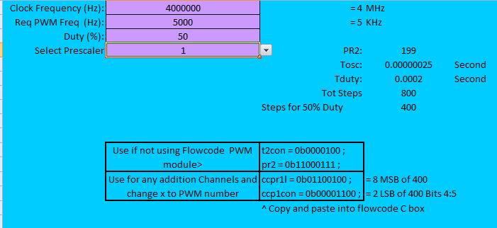

This would be useful if you are already using both PWM components in Flowcode, and would like to set-up the third
If you are using 1 or more PWM channels with Flowcode then Both t2con and pr2 are not required.
Instructions: Just enter clock frequency , PWM frequency and Duty.
On flowchart Place a 0 output for each CCP in use. e.g if CCP3 is RB5, then use an output icon with B5 set at 0
Select prescaler to give highest Pr2.
Copy and paste cells containing required values into a flowcode C box after output icon e.g.
t2con = 0b0000101 ;
pr2 = 0b11111001 ;
ccpr1l = 0b01111101 ;
ccp1con = 0b00001100 ;

Note example is using fosc=4MHz, fpwm=1KHz & Duty=50%
The code for pasting into C box will automatically change as you alter PWM frequencies, prescaler etc., removing all the hard work and saving time.

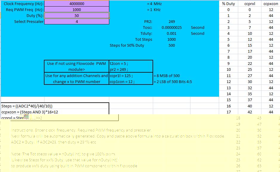

Thanks Ben. I have now completed excel sheet to produce a lookup table for duties from 0 to 100%. All is required is cells to be copied and paste into supplementary code box. Eg if duty of 34% is required, correct values (if I have got calculations right of course
) will be retrieved, and pwm3 will be set.
Just got to get flowchart to compile now

I have modified the excel sheet to produce a formula that can be copied and paste directly into flowcode calculation box. Then the value of ADC2 = duty % of pwm3. This takes all the maths away form some one who wants to use a third PMW channel.
I have included a flowcode sample (Flowcode V4), which has 3 pots to produce 3 PWM with adjustable duties.
At this stage I can't guarantee accuracy of of third PWM.
I have posted for any one to test,I would be really grateful if any one could test and post some feed back please E.g does it work OK, and if not, what is the issue .
Thank you.

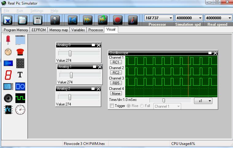

Using Flowcode to run 3 PWM O/P's instead of usual 2
Update: All three (or more if you have them) PWM channels are working, and appear to be spot on, after revising formula.
It has taken several attempts because the formula to calculate CCPxCON and CCPRxL using Fosc, PWM Freq was not easy to reduce enough for PICs to handle using 16bit signed maths. I have tested on 19.6MHz and 4MHz ,using PWM Freq of 2KHz and 1KHz respectively. independently Varying three pots produced correct PWM duty for all 3 channels.
Hopefully this will be useful if you want to run and control 3 or more PWM channels using Flowcode.

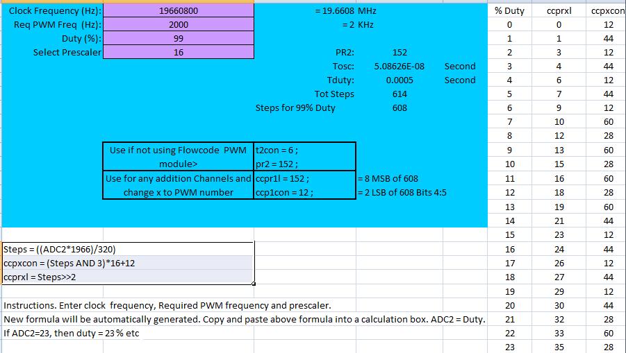

Re: Using Flowcode to run 3 PWM O/P's instead of usual 2
Screen shot of revised formula within excel (post above).
