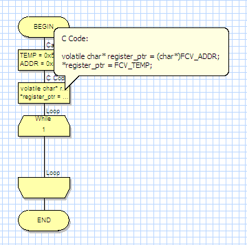

Re: write to flash component
For those that are following this, Ben just sent me some alternative C Code for Reading and Writing to the Flash Memory area on the PIC. Apparently there is a problem with getting the original examples to compile in FlowCode.
Here are the new versions:
FCV_TEMP = byte to be written into Flash memory, or value that was read from Flash memory (from FlowCode this would be variable "TEMP").
FCV_ADDR = 16-bit integer for Flash memory address where byte will be written to, or read from (from FlowCode this would be variable "ADDR").
This code appears to compile properly, although I have yet to actually try to use it with real hardware.
benp -- you originally started this thread and mentioned writing your own C Code blocks for accessing Flash memory. Is this example similar to what you were doing?
/* Read from Flash Memory
volatile char* register_ptr = (char*)FCV_ADDR;
FCV_TEMP = *register_ptr;
/* Write to Flash Memory
*register_ptr = FCV_TEMP;

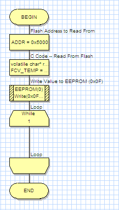

Hi benp --- thanks for uploading your code (I'll be looking it over after this post).
I am using an ECIO-40P which has a PIC18F4455 on board.
Well I am now testing benj's flash read/write examples in hardware and I am seeing something rather unusual.
So here is what is happening: My program at first appears to be properly updating individual flash memory locations, which can be verified by playing it back (program spits it out sequentially via a USB HID keyboard routine). However if I either reset the ECIO or power it down, the resulting flash playback is not the same as what I originally put in there.
What I have also noticed, is that the data that appears after a reset, is very consistent (although not what I thought I had written into the memory cells). So I am somewhat confused. Its as if the flash memory is being treated more like standard RAM, and remains accurate only while the program is running and uninterrupted (no reset, or power down). I wouldn't think this is possible.
Anyway assuming your explanation holds true for the chip I am using, this could possibly explain the problem I am seeing.

Well to eliminate any doubt that my program was inadvertently messing something up after reset, I wrote a very very simple FlowCode program to write a single byte (0x55) into a single location (0x5000). I then compiled this to chip via FlowCode, and let it run. Then I ran the ECIOprog.exe file, pressed the reset button on the ECIO, and when the ECIOprog found it and gave me the "Ready" prompt, I had it read the chip and saved the hex file. Then I ran my MElabs Programmer application, opened the hex file, and scanned through the file. Except for the small amount of code at the beginning, the rest of the file contained 0xFF's, including location 0x5000.
So it appears that the BoostC Code to write to Flash is not working... any ideas?

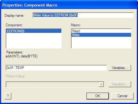

For my next test, I decided to also see if the Read-from-Flash example that Benj used was actually working properly.
C Code -- Read from Flash
So I wrote this simple FlowCode program to test it:
Not having any display device attached to my ECIO-40P, I opted to send the results of my Flash Read to the EEPROM component, and write into one of the EEPROM's memory cells. At first I wrote into the first cell at location 0x00. And then later I wrote into location 0x0F. The value in both cases was coming from Flash address 0x5000, which held a default value of 0xFF.
Anyway after each test run I read the ECIO's memory and scanned through it. On the first run I would get a 0x0F in the EEPROM cell being written to. On subsequent runs I would get 0x00. Very odd, and not what I expected to see.
So Benj I await your response and explanation as to what I am seeing.
