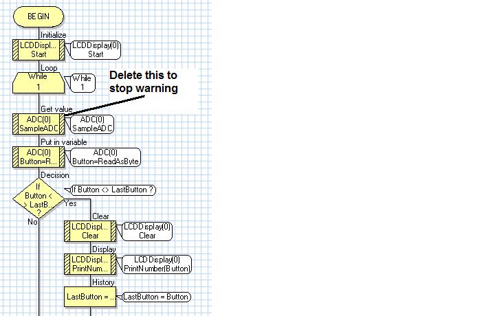

As for 'The following macro will be ignored'
With Flowcode V3 you need both 'SampleADC' and 'ReadAsByte'
With Flowcode V4 you only need 'ReadAsByte' since SampleADC is automaticly done now.
So to get rid of the second message, Only in Flocode V4 and above (when applicable) just delete the 'SampleADC' Macro'

Thanks medelec35 for the feedback. However I do have a question relating to deleting the 'SampleADC' Macro, and it simply comes down to how do I do that? Remember I can not see any macros other then the Main one, and the option to delete macros is grayed out. Would I have to first open this program up in V3 and delete and save it there? Or is there some other way to do it in V4?

Each component is treated as a macro. so u will need to delete the ADC component, SampleAdc. Not talking about about the macro Tabs you can create by clicking 'New macro'

:lol: I really should have known that. Time to wake up and get some caffeine in my system. And yes deleting that entry did take care of the problem.
