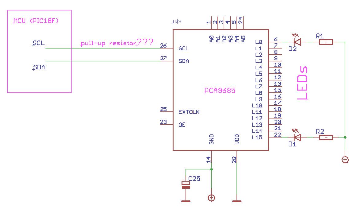

I'm interested in the LED driver PCA9685 (something like PCA9530DP, PCA9685 is 16-channel, 12-bit PWM driver, datasheet). As a master I2C device I want to you some PIC18F, too. Can you show me the circuit of 2-bit dimmer?
I´m not sure about pull-up rezistors on I2C lines - can you help me witch the schematic? I never use I2C..
Thank you very much

The SDA and SCL lines will each need their own resistor between the line and the positive supply which will be 5V or 3.3V depending on your system microcontroller voltage. The resistors should be around 4.7K though as high as 10K or even 100K should also be fine. If in doubt then the manufacturers datasheet for your I2C device should give some example values for the pull up resistors. I have also seen some I2C devices that have internal pullup resistors however when this is the case you can normally only have one of these devices on the bus as you should only have one set of pull ups per bus.
