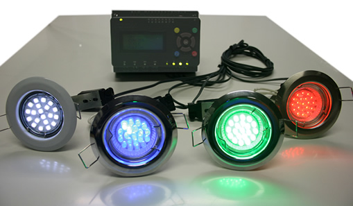

This article demonstrates the use of a MIAC (Matrix Industrial Automotive Controller), programmed using Flowcode, to control a multi-channel, low voltage, dimmable, LED lighting system.
Lighting System 2.jpg (59.01 KiB) Viewed 6480 times
These notes detail the development of a multi-channel MIAC lighting control system.
The example program accompanying these notes is written and illustrated using Flowcode. The program includes a software controlled PWM signal generator for efficient multi-channel brightness control and LED brightness characteristic correction.
Technology
Recent developments in technology have allowed LEDs to become a realistic alternative to incandescent bulbs in many lighting applications. The high efficiency and long operating life of LEDs have important environmental implications.
The efficiency of LED bulbs makes them suitable as direct replacements for incandescent bulbs in low voltage lighting systems. Many are commercially available in packages that are compatible with standard light fittings. The bulbs are relatively easy to control and can be built into flexible lighting systems using safe, low voltage, electronic circuits.

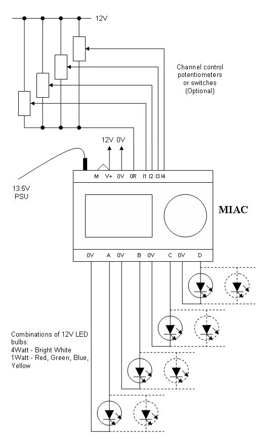

A MIAC can provide fully programmable control of up to 8 lighting circuits. Four controlled by transistor outputs (all with PWM control), and four controlled by relays. In addition, there are eight inputs that can be used to read switches, potentiometers, and a variety of sensors.
Each MIAC transistor output is capable of supplying approximately 6Watts at 12V. This means that each channel can control a single bright-white 4W bulb, or several 1W coloured bulbs.
The Relay outputs are not suitable for PWM control, but are capable of supplying 96Watts each at 12V and can be used for low frequency switching of large banks of lamps.
Example program
The example program is a four channel analog to PWM light controller. Each channel (A, B, C, D) can be independently controlled by connecting a suitable analog signal source to the corresponding input (I1 = A, I2 = B, I3 = C, I4 = D)

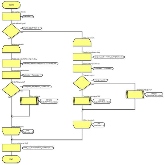

PWM
PWM (Pulse Width Modulation) is an efficient method for simulating analogue levels by rapidly switching a signal on and off at specific time intervals.
The PWM signals used to control the brightness of the lamps in this example are generated in software and controlled by a timer interrupt. This allows PWM control to be available on all four transistor outputs. The resolution of the PWM has been set to 6 bits, which is adequate for this application, and results in a good trade-off between interrupt frequency and PWM cycle period.
The timer interrupt occurs every 85.3μs and increments a byte variable, PWM_COUNTER, by 4, causing a cycle repeat every 64 interrupts (5.46ms - 183Hz).
The duty cycle (brightness) value of each channel is calculated in the main program loop and stored in a four byte array, PWM_DUTY[].
Each time the timer interrupt occurs, the handler macro reads the channel values fro the array and performs the following operations:
IF PWM_COUNTER = 0 (start of a PWM cycle)
Turn ON the output of any channel with a non-zero duty value.
ELSE
Turn OFF the output of any channel with a duty value that matches the current value of PWM_COUNTER.
ENDIF
Increment PWM_COUNTER
MIAC_PWM_LV_Lighting.fcf Macro - Tick 2.JPG (24.26 KiB) Viewed 6480 times
Example of an interrupt handler for software PWM
