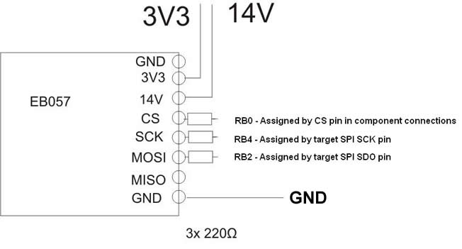

Graphic display EB057/58 connections
Dear Steve/Ben
Today the E-block EB057 arrived. But I do not understand the connections. Or better said I miss the reset.
The Circuit diagram of EB057/058 *) shows the 4 connections: CS Chip Select, SCK Serial Clock, MISO Master In-Slave Out and MOSI Master Out-Slave In. As I understand it correctly MISO will not be used and MOSI is the data input from the PIC microcontroller to the gLCD. What I'm missing is the RST (Reset) connection. The connections to the Sub D connector are for 16F88 microcontroller are: CS 1, SCK 6, MISO 3, MOSI 2 (numbering from 1-9).
The Flowcode V4 example, from http://www.matrixmultimedia.com/Flowcode3a-X.php, like 1. 3D Text Example, see attachment, shows the following connections: B3 Reset, B2 Chip Select, B1 Clock and B0 Data. It may be clear that this does not fit without some additional information.
Questions:
1) What to do with the Flowcode Reset, while EB057/058 does not have a reset connection?
2) Is it correct that MOSI on the EB057/058 must be connected to "Data" in the Flowcode?
3) Is it correct that MISO on the EB057/058 is not used in the Flowcode?
Thanks already for your help.

Re: Graphic display
Hello Jan,
The next release of Flowcode will fix this issue.
To start with you will need the latest gLCD component code file which is available from here. Copy the file into your "Flowcode v4\Components" directory and overwrite the existing file.
The component connections shown for the component are incorrect. Only the CS signal is actually used by the code. The other signals are dictated by your device and the pins are marked on the chip diagram or device datasheet as SCK, SDI and SDO.
The MISO signal (SDI) is not specifically required as currently there is no data that comes back from the display to the microcontroller. However it is good to use it for the board because it is assigned to the SPI peripheral and therefore you cannot use it for normal I/O operation while the gLCD is operational.

Re: Graphic display
Dear Ben,
Sorry, but it is hard for me to follow your advices as far as the exact the connections are concerned.
You said, CS(Chip Select) is the only code used. Does that means that I need only to connect the CS of the EB057 to the microchip (eg. 16F88) and can deny all other connections? If more connections are needed, please give the EB057 connectors which has to be connected to the microcontroller 16F88 pins B0, B1, B2 and B3 with the flowcode B0=Data, B1=SCK, B2= CS and B3=Reset.
regards,
Jan
regards,
Jan
Re: Graphic display
Hello Jan,
Here is a picture showing how to wire up the EB057 gLCD when using a 16F88.

Re: Graphic display
Dear Ben,
I have still one question. The hardware does not use the RESET, while the RESET is programmed in the software. In the flowcode the RESET can not be set "not connected" (this will give an error). The result is that one input/output pin of a microcontroller is blocked by the software. And that is a pitty.
The questions is what is the reason to use the RESET in the Flowcode and the software? If not used, will this RESET remains in a future version? And is there now a possibility to use the RESET pin for other input/output functions?
With kind reagards
Jan Lichtenbelt
With kind reagards
Jan Lichtenbelt
Re: Graphic display
Hello Jan,
The pins shown in the component connections window other then the chip select pin are not called by the C code and as such can be used by any other Flowcode component or a normal input or output icons etc. Note that you may get a warning if the pin is assigned to another component but this is nothing to worry about. Future releases of Flowcode will contain a fix to the gLCD component where if the EB057 module is selected the only pin in the component connections window will be the chip select pin.

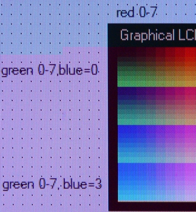

Colors of Graphic display
Colors with the RGB settings are shown in the picture attached. Horizontal red changing from 0 to 7. Vertical from top to bottom, green from 0 to 7. This is repeated for each blue settings of 0 to 3 from top to bottom.
- gLCD RGB.jpg (191.62 KiB) Viewed 19720 times

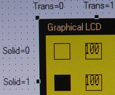

Transparent and Solid Drawbox of Graphic display
Drawbox has two parameters, Transparent and Solid. That means four combinations. See the picture with four boxes, all first filled with the number 100 and there after used Drawbox(...Transparent,Solid). The foregroundcolor is black (RGB=000) and the backgroundcolor is yellow (RGB=770).
Transparent=1 gives the same results for Solid is 0 or 1, showing still the original number. Transparent=0 depend on the Solid value, as shown.
What if you want to delete a number by means of a box, without any black, just yellow. Change the foregroundcolor into the blackgroundcolor, in the example equal to yellow (SetforeColour(7,7,0)) before drawing the box. Don't forget to set the foregroundcolor back to the original color (here black) after drawing the box.
Good luck
Good luck

Re: Graphic display
Hello Jan,
The only pin that is used from the component connections when using the EB057 or EB058 is the chip select pin. None of the other pins are used by the code. This was just a way of getting the updated component out quickly. The new version of the component that will be released in the next update version will only present the chip select pin in the component connections window when using the EB057 or EB058 displays.
Hope this makes sense.

Also what would be ideal is a font/line colour chart. similar to the one Jan posted picture of that would give the three number combinations for a range of colours.
Or even better you click on the colour (form the whole spectrum of colours) and all three values are given just like in the picture below: Hmm, wonder if I can use this but just work out the equivalent ratios from 0 to 7 for red green and blue?

It you run Paint (I’m using the one shipped with windows 7)
Then click Edit colors.
Click inside the colour spectrum block to desired colour e.g. orange, then move the slider on the right until correct brightness I achieved.
Divide each number given within colour by 255 then x 7. Place these numbers in the SetForeColor & SetBackColor postions?
Would this give the correct font or background colour? Eg for the attachment
Red = 249/255*7 = approx 7
Green = 119/255*7 = approx 3
Blue = 32/255*7= approx 1
If this does work (at this stage I’m not saying it will) then since the colour number range on paint goes from 0 = 255 but on gLCD go from 0 – 7 there will definitely be limitations/differences.
