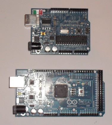

Three of the main targets are the Duemilanove and Mini (ATmega328) and Mega1280 (ATmega1280). The USB connection is handled by an FTDI USB to serial chip. Drivers for this device are widely available and are included in the free Arduino programming software download - available from http://www.arduino.cc.
The Duemilanove and Mega1280 have recently been replaced by the Uno (ATmega328) and Mega2560 (ATmega2560). The new boards have an alternative USB interface chip (a USB ATmega device) that requires different drivers to the FTDI chip. The newer drivers are also included in the latest Arduino download (Version 021).

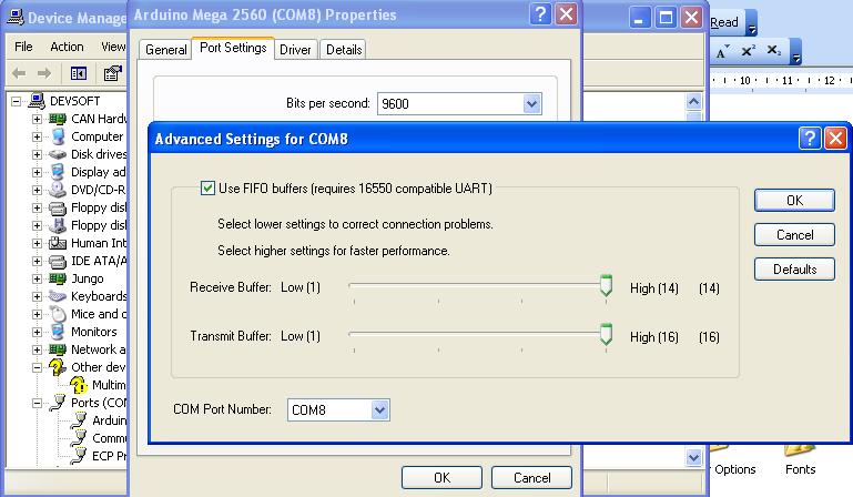

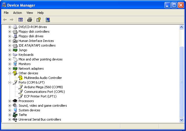

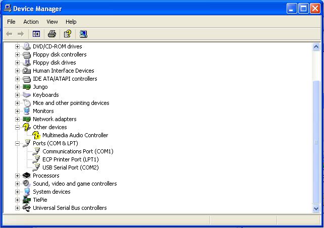

The USB connection appears as a virtual COM (RS232) port. The new com port number needs to be identified to it can be used as a parameter by Flowcode.
Boards with the FTDI chip appear as 'USB Serial Port (COM2 in this case)
The newer boards identify themselves more clearly.
If the COM port number allocated by Windows is too high, the programming software might not be able to locate it. In this case the port number can be changed in the advanced properties of the driver. It might be necessary to reclaim a low numbered COM port that is indicated as being already in use!

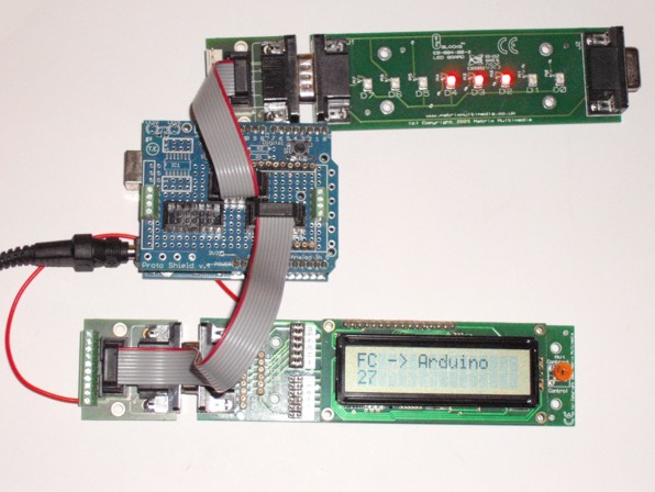

Arduino boards make I/O connections available using header sockets. These allow some component leads to be inserted directly. The sockets also allow connection of the 'Shield' expansion boards. Some of these are for specific applications, but prototyping versions are also available.
Using a prototype Shield board it is possible to make the I/O connections available in a more convenient form. The example board pictured uses the standard Atmel 2x5 pin headers to make the I/O available as individual ports. Additional ribbon cables and converter PCBs then provide the D9 E-blocks connectors.
The D9 connectors could be soldered directly to the Shield board, or wired to headers and inserted directly into the sockets on the main board.
