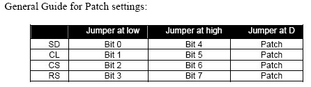

One other thing I have noticed. You connections are different from the default.
looking at your gLCD connections:
Reset = C1
Chip Select = C0
Clock = C3
and Data = C5
Data Sheet shows:
gLCD settings.jpg (14.12 KiB) Viewed 6873 times
Should you also have same settings?
or have you re-patched?
Plese note: I have not used gLCD myself, so im by far not an expert on it. So last bit of information about pin settings could be wrong.

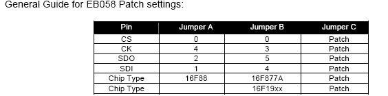

swatzy wrote:with regards wiring, I don't know where you got that patch diagram, can't find it in my docs. I'm pretty confident that the way I have it set up is correct,
Ahh I have just doubled checked and posted the wrong table. :oops: Sorry.
I meant to have posted this one:
patch EB058.JPG (16.35 KiB) Viewed 6857 times
Which is from EB058 data sheet.
But your probably right, your settings could be correct, since worked before.
Also they do correspond to the above data sheet.
